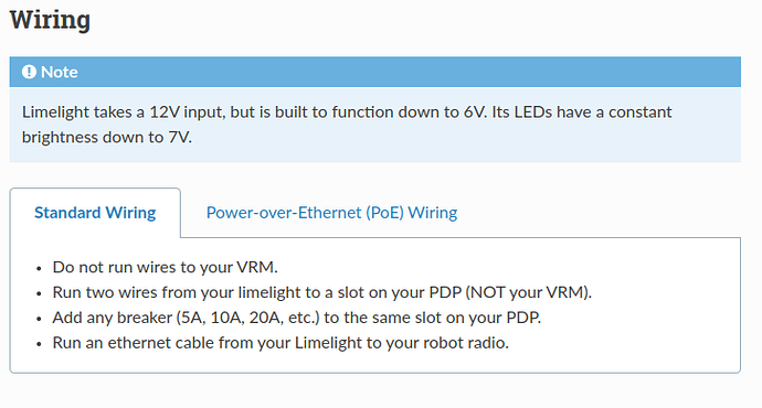

The thing I am trying to do it to connect a limelight camera without using one of the 16 motor controllers port, while having PCM with compressor
You want to look at R48.
The VRM supplying power to the Wireless Bridge per R47 must be connected to the designated supply terminals at the end of the PDP, and not the main WAGO connectors along the sides of the PDP as shown in Figure 9-12. With the exception of a single CTR Electronics Pneumatics Control Module (PCM, P/N: am-2858), no other electrical load shall be connected to these PDP terminals.
So, one VRM on those terminals, and at most one PCM. Additional VRMs or PCMa have to be connected to a 20 A breaker.
I think that you will have to put it in your PDP. If you look at their quick start guide it says this.
so you will need to connect it to a PDP port that you can put a motor in.

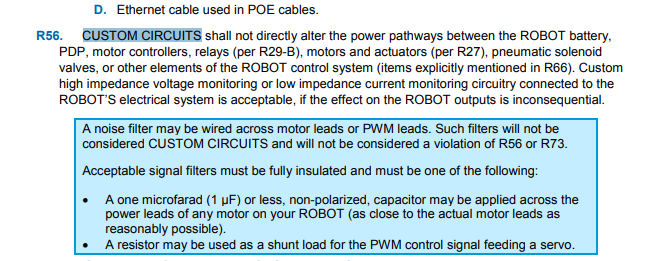

And another question:
Is it possible to connect custom circuit to the pdp port, the custom circuit has two outputs, each output will be connected to a dedicated motor controller (spark max to NEO 550.
no

I really suggest you read section 9.7 in the Robot Rules (R32-R56). All of these questions are answered in there.

Then the better way to ask questions is to reference the rule you want further explanation on, and explain your thinking as to why it shouldn’t apply to what you want to do. Otherwise, all you’re going to get (as you’ve gotten here) are people like me pointing you to the rule you’ve already read.
You can legally power 16 motor controllers and the limelight by powering the limelight from a COTS USB 5v battery pack <100Wh in capacity. If you’re not using the Limelight 2+, you will need a boost converter to get from 5V to 12V. That being said, I would recommend you simplify your design.
even though LL tells us not to connect to VRM (this is overkill and “risky” to connect in parallel to your radio). Isn’t it legally “okay” to do so?
