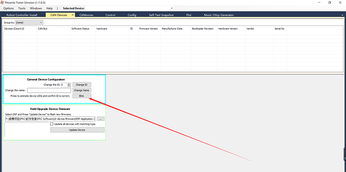

I know what you mean, but how do you clear it with phoenxi Tuener?
Is that the button?
We have solved this problem. Thank you for your help
