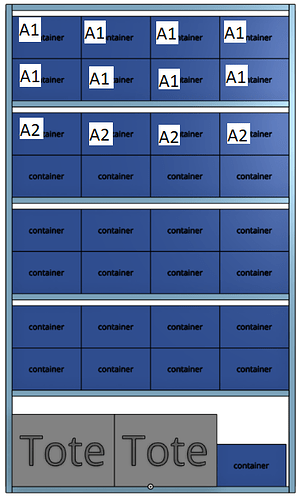

Task 1 - parts sorting and storage
On recommendation from Allison // 3538 - I bought some sterilite containers to try out. Before we had used some of those commonly seen bins from Harbor Freight or Home Depot. They’re nice, and still used for some things - but I have become a sterilite fan for sure. They’re almost a perfect size for our shelves, and I can do 4 stacks of 2 on them. Stacking 2 I find to be acceptable, stacking more than 2 strongly discourages people from utilizing bins on the bottom or middle. They’re also small enough that for most items you store in them, they won’t get too heavy to be cumbersome or stress the structural integrity of the bin.
We have 5 shelving units with 4 shelves on each shelf. There are some other shelving units besides them that will end up being lumped in with this organization effort that are slightly different. With 8 bins on each shelf, that provides space for 160 sterilite bins. I bought this 144 pack from walmart that’s a little bit more than $5/bin. I want to group like bins together, and label shelving units with letters and shelfs with numbers. So a group of 8 bins will all be labeled with one bin and one number (ie “A1”). Where the bin is within that group of 8 shouldn’t matter too much, and if it moves around a little it’s not too hard to look at the 8 spots where it’s supposed to be.
There are some bins that I’m going to take some liberties with what goes in and how we label them. For instance - we primarily use M5 bolts with the ultraplanetary gearboxes, so that bin may have some smaller boxes of M5 bolts with it. There is some risk that this ends up being too non-intuitive to new students and will need re-evaluation, but I think that this is better than a student not knowing what bolts to use and trying a bunch of other bolts and forcing the wrong thing. Similarly, we only use the jst extention boards with spark maxes, so we may put spare cables and joiner boards in the spark max bin.
Here are some thoughts from this past fall for some potential bin organization. I am going to re-look at this in the coming weeks and change some things about it: Shop organization - Google Sheets
Also, to help visualize, a shelving unit will be labeled A, B, C…H and have shelves 1…5. So there will be 8 bins within A1, 8 bins with in A2, etc like the following crudely done image

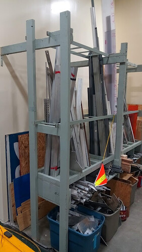

Task 2: raw material improvement
Fall of 2021 we built a pretty simple holder for raw materials. It was pretty decent, but not great. I’m not sure if it’s that we just have too much, we don’t manage putting this away well enough, or what - but I think we miss utilizing scrap pieces first and don’t know what we have. You can see pictures of the set up, and the intended utilization here. It’s primarily material that we put on the CNC router (which we have a 4x4 bed, but have also done some things that limit it’s usable area to a little bit smaller than 4x4).
What I’d like to do is just accept that we’ll cut almost everything down to 4x4, or perhaps even 4x2 and store in in a set up more similar to this: https://www.grainger.com/product/GRAINGER-APPROVED-Horizontal-Sheet-Storage-Rack-1BBY4
We also need to figure out better ways to store and manage our tube/flat bars. I am open to suggestions on that - right now we a rack that we store most of our rectanglur tube and flat bars; we store solids on the bottom, ⅛” on the 2nd (from the bottom) shelf, 1/16” on third shelf, and wood on the top. We have an A-frame shelf that we store axles/shafts/PVC on. That might be mostly OK as is and just needs some TLC in reorganizing and getting rid of things we don’t need. The picture shown is after some clean up/before build season.

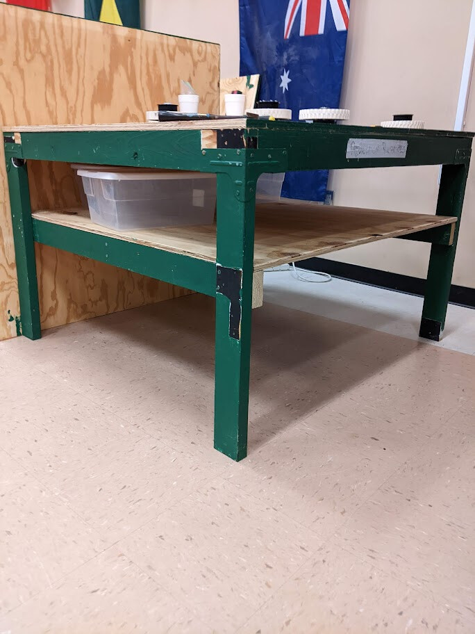

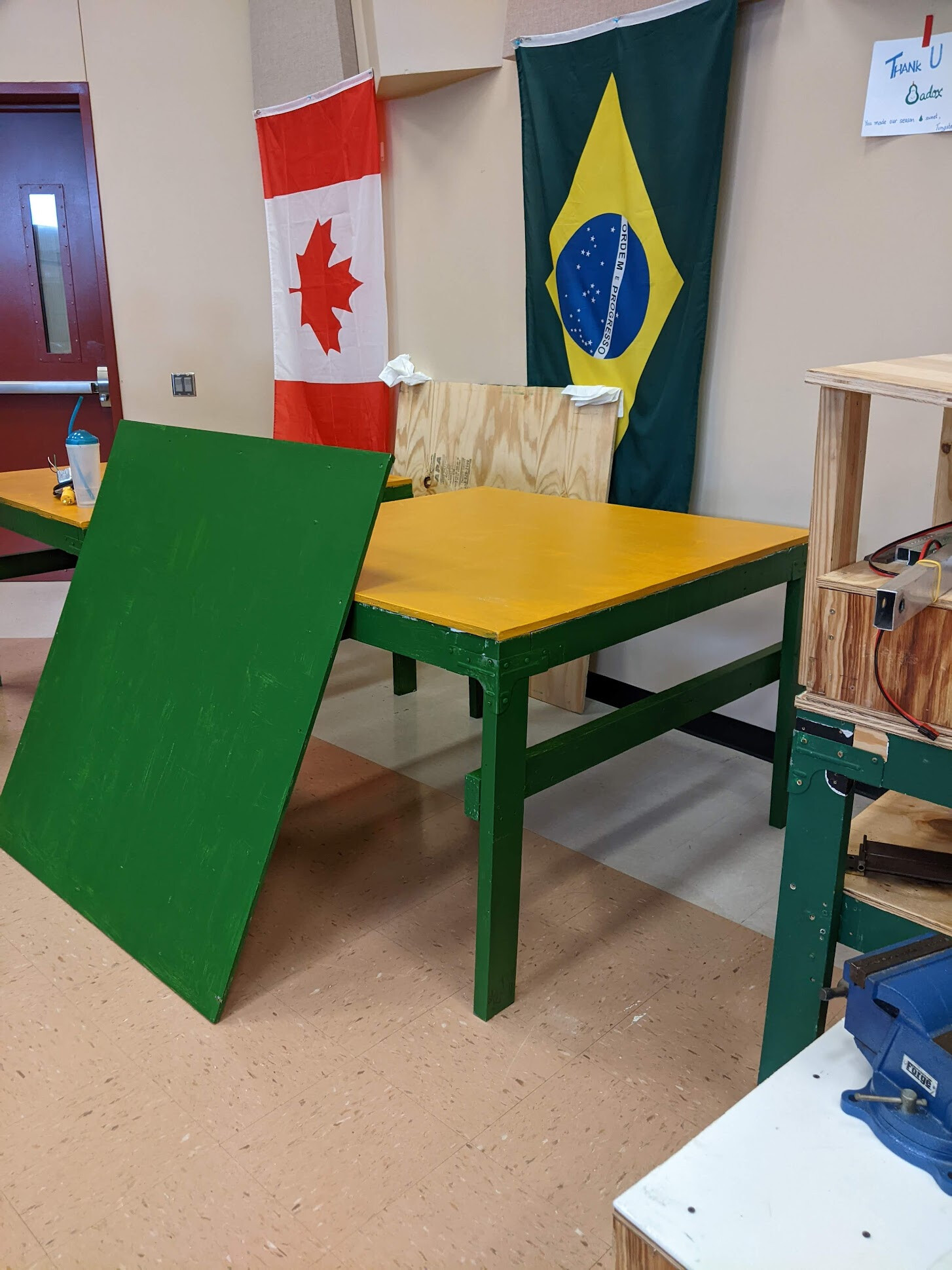

Task 3: New work tables
We build these tables primarily in our rookie year. I will need to get some better pictures of these tables - but you can see our 4x8 and 4x4 picture here. They have served us well, but they’re sort of an awkward size. Additionally, I’d like to have it set up a little bit better for storage of materials underneath it. We may want to keep one or two larger tables for working on a whole robot, but I think I’d generally rather move towards more slightly smaller work tables. I’m not sure how small is too small. Really it’s just the depth that I think is the issue, if it were 8f by 3ft (something closer to the max robot width), I think it’d be better.
This is a lower priority - but I am also wide open to suggestions on this. I conceptually like these tables from Home Depot or something similar.

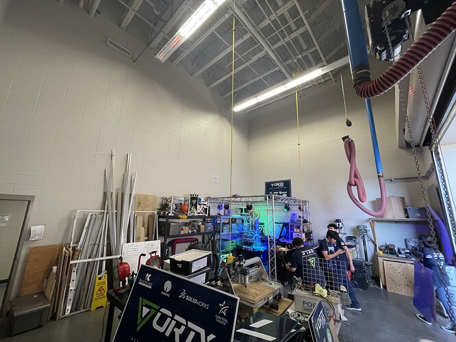

Task 4: Super Pit
The kids really want to build one (and I do too but $$). I am including it here just because it would also arguably help our organization. We currently sort of have 2 “pits” set up. Our normal competition pit, and then another “working pit” that we encourage students to pull tools from first. This is currently in the middle of some of our work tables.
  • Close up of our “working pit”
  • Relative location of our “working pit”
  • I don’t currently have a good picture representing our “comeptition pit” set up, but it’s in this area (it’s just missing a lot)
Our “working pit” is where we’ll keep fasteners. I need to spend some time thinking about how we store them, it’s currently a mess. 118 had some really nice milwaukee cases I think for their bolts, and I may be copying a similar set up. It’d be really nice to replace some of these shelving units with some lista cabinets, but $$$$

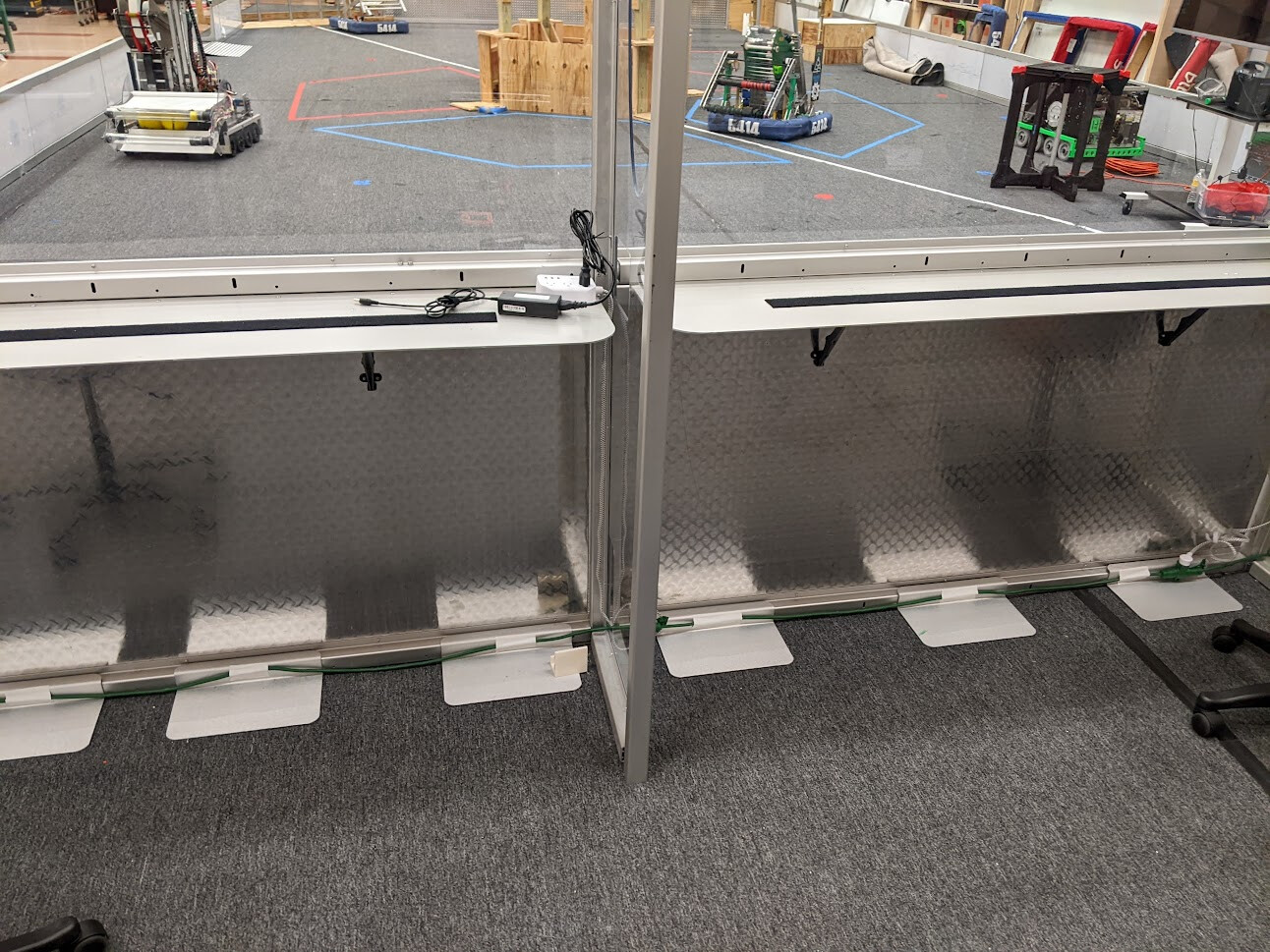

Task 7 - field set up
Add extension cables and chargers at each driver station. Right now we usually run an extension cable to a driver station whenever we want to test from it. I’m thinking I might just get some outlets more permanently set up

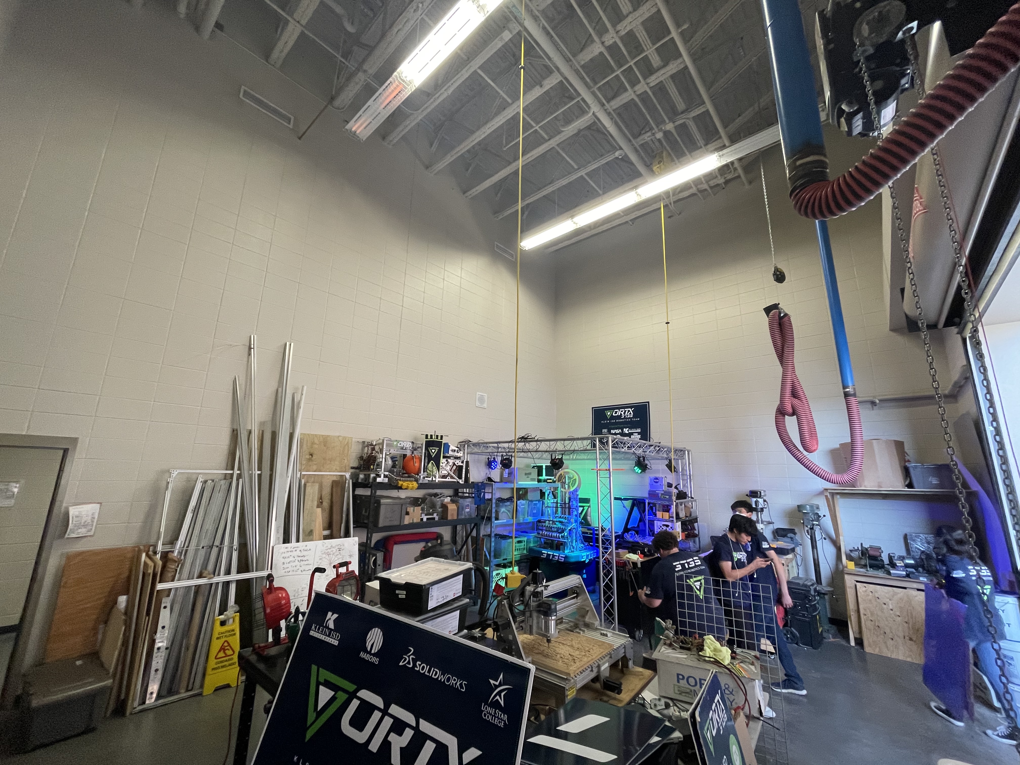

Rounding out the post with pictures of our space
I apparently don’t currently have pictures of our chairmans room. I try not to interfere with them. It’s also where we host our Brilliant Black Builders and Gearbox Girls meetings after meetings.

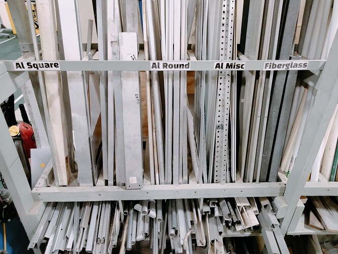

Not really sure how other people do it, but we store our tubing vertically out of an 80/20 frame that we built. You can see it pretty well on the left side of the photo.
I made this storage rack a few years ago with 2x4", plywood, and cable ladder for servers. I’d offset it from the wall to help keep the tubing from scraping on the wall, and then I could slide larger 4x8’ sheets behind it there. I built it above high enough to place scrap bins for metal below it. Then I also build a lower shelf than can store some shorter pieces of tubing that are slightly shorter than the lower ladder.
edit: The cable ladder was 12" width (with ~8" wide between channels). The first rack is 2 ft above surface, and second is closer to 5 ft above surface. For some reason I set the higher ladder back about 4" from the first probably thinking it might be easier to lift it out. The rack is about 20" from the wall, it could be closer and less angled but it fit the space.

Driver Station Set up
I bought some extension cables and power strips to be able to have a permanent power set up at every driver station. This will hopefully prevent some commonly re-occuring trip hazards, make it more likely to have laptops charging in our laptop cabinet (by having duplicate chargers permanently in the laptop cabinet), and make it more convenient when we have guests over to practice on the field.
6x power strip with USB outlets too for phone charging
2x 35ft extension cable with an outlet every 5 ft
1x 50ft extension cable because we have only one good outlet available for the field
New Work Tables
Some students made adjustments to our work table design, tore down and old one and rebuilt it. I forgot to take a picture of it, but it is not 4’ x 4’, has space on the floor shelf for KOP totes and space on another shelf for sterilite bins. We had some pretty ugly wood exposed for the table top, so right now some saw dust and wood glue is sitting in some cracks and knots to give us a flatter surface. We’ll see how that stands Saturday and hopefully sand it down.

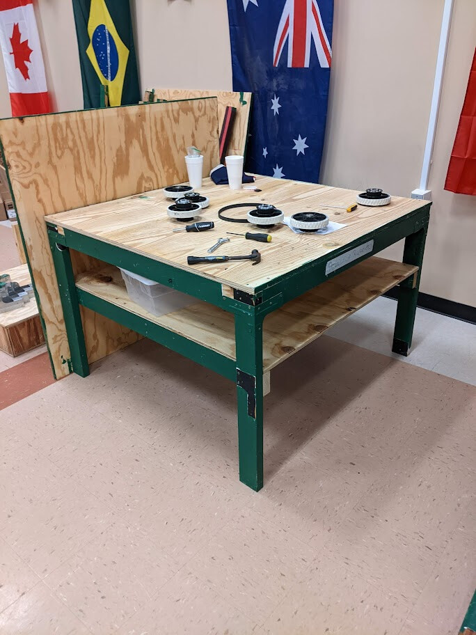

New table set up. I am happy that we can fit a KoP tote underneath, and a sterilite bins on the shelf. It also gave us another chance to use some very large bar clamps (probably these) that we have:

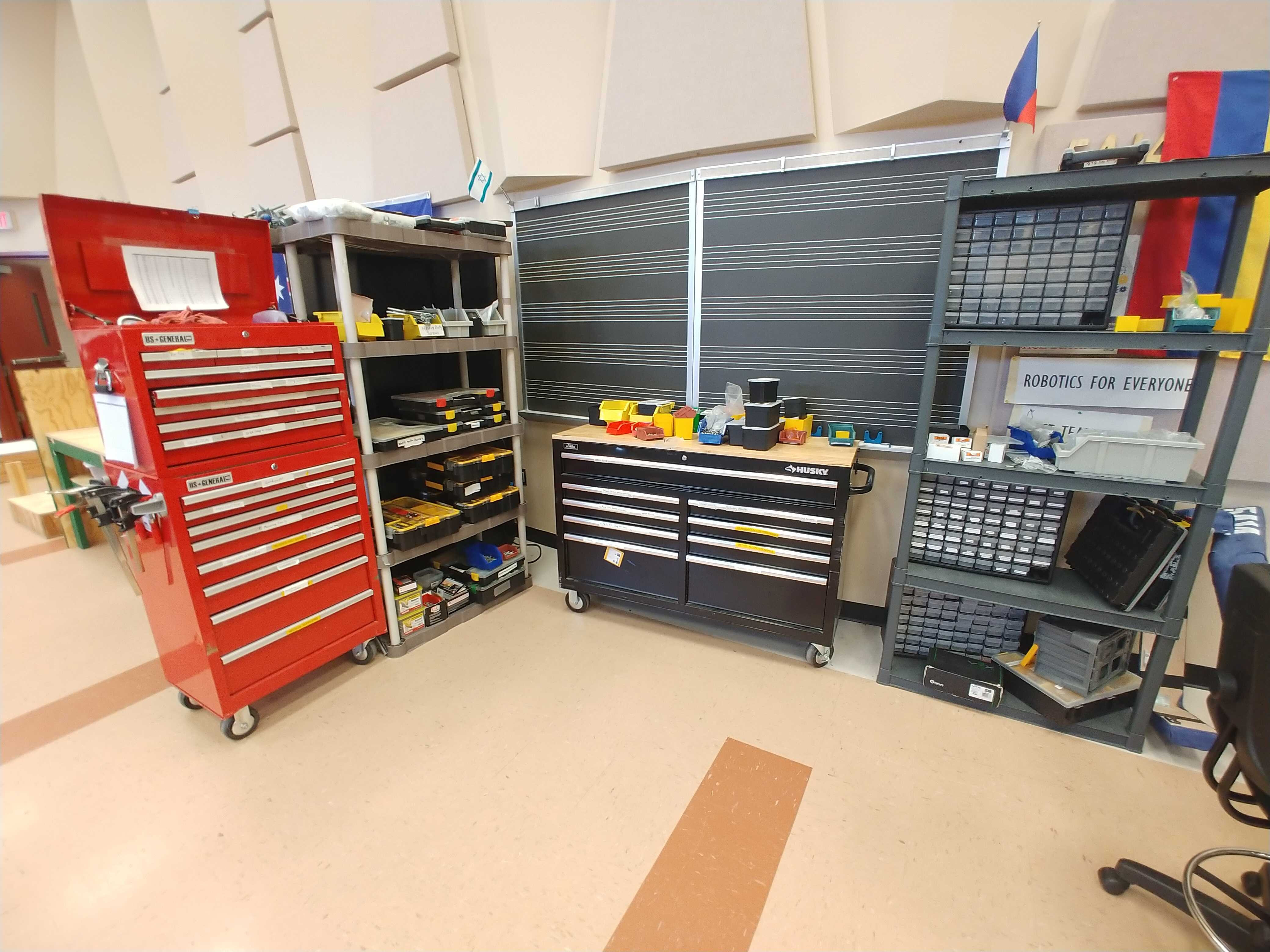

“Working pit” area:
black cabinet that’s on the backside of the shelves with fasteners next to the red toolbox

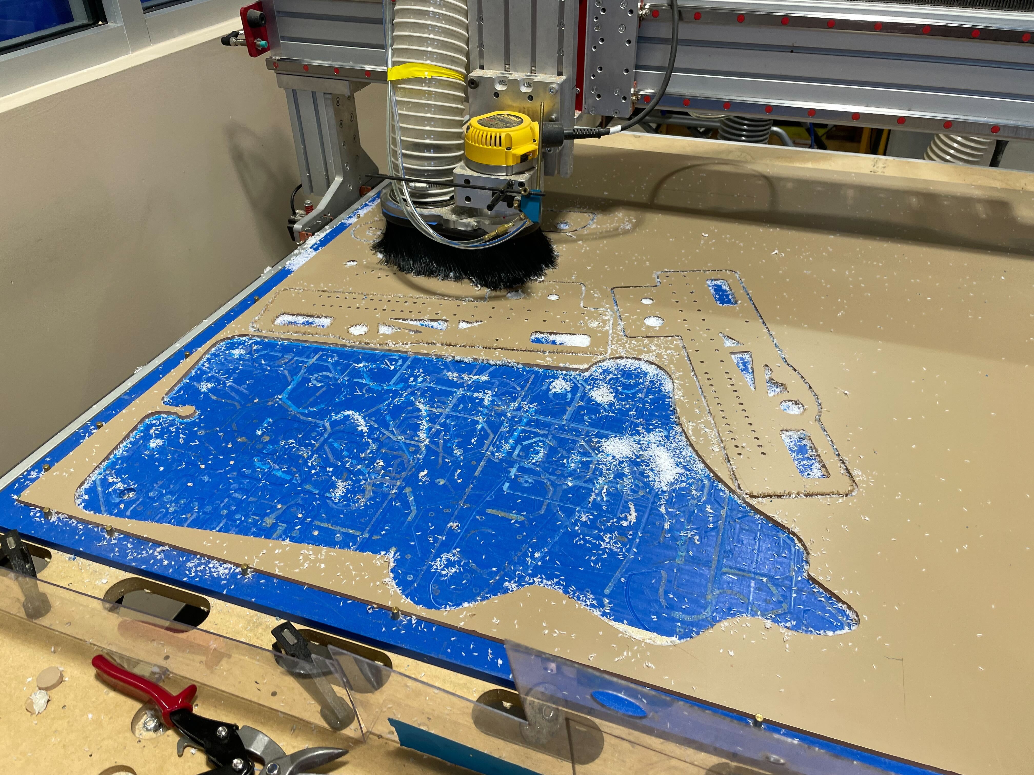

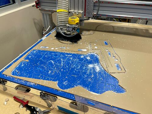

In today’s meeting, we started work on 2 more tables and got those mostly done. we’ve also begun assembling the swerve robot that I mentioned in my last post, after finishing up the last few parts from the previous meeting I started work on “upgrading” the CNC, mainly how we mount and work hold things, and now I will spend way too much time talking about it because that’s all I did today and I’m excited to try it out. Up to now, we’ve been using double-sided tape to work hold basically everything and it works great to keep things from moving. Still, we find that it can throw off our Z accuracy as well as stick to tools and makes them worse at chip evacuation, as a solution we’re installing some #10-32 screw to expand inserts into the HDPE spoil board we’re using. we plan to put them in a regular grid pattern so that before we cut out parts we can go through and drill through holes that will let us screw the parts down.
That should allow us to deal with most of our plate material as for tubes we have an Ozzy Board TubeMagic (v1) and after taking a test indicator to it even with all the surfaces parallel we’re still seeing about 10 thou run out over 6 inches and in some places we’re seeing 10 thou over an inch. we don’t really like that for some of our more critical machining for things like belt and chain C to C’s. As a solution I made some CAD of eccentric cam’s that can be used to hold tubes, this in combination with a set of dowels we already use to index sheet and plate materials these cams in combination with the aforementioned screw inserts should let us machine both tube and plate without me having to spend an hour tramming the tube jig. which I like because it makes less work for me :slightly_smiling_face:.

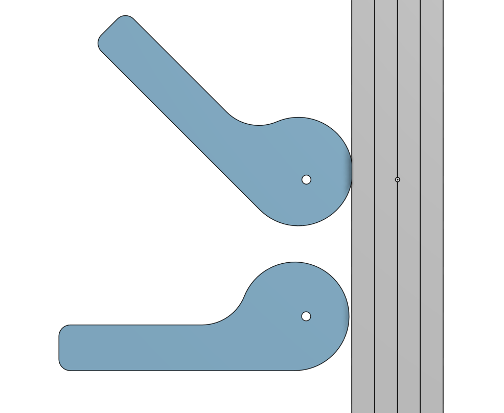

Hi! Would you mind talking a little bit more about how you plan to use the cams to hold in the tube stock? We were having trouble with an effective setup for tubes, but I want to experiment with it over the off-season.
I’m always down to share more. The cams are doing the same thing as the mitee-bites you would see on the WCP tube jig, the only difference here is we’ve tried to make them easily CNC’ed and tool-less once they are installed so we can rapidly switch tubes. They work basically by attaching to a hole 1 inch of the face of the tube, the cam is designed that when the handle is perpendicular there’s room to insert or take out parts, and turning it either way to a 45-degree angle should touch the tubes so you just need to push it a little past 45 to get a good clamp the tube.
here’s a little example I made in onshape.

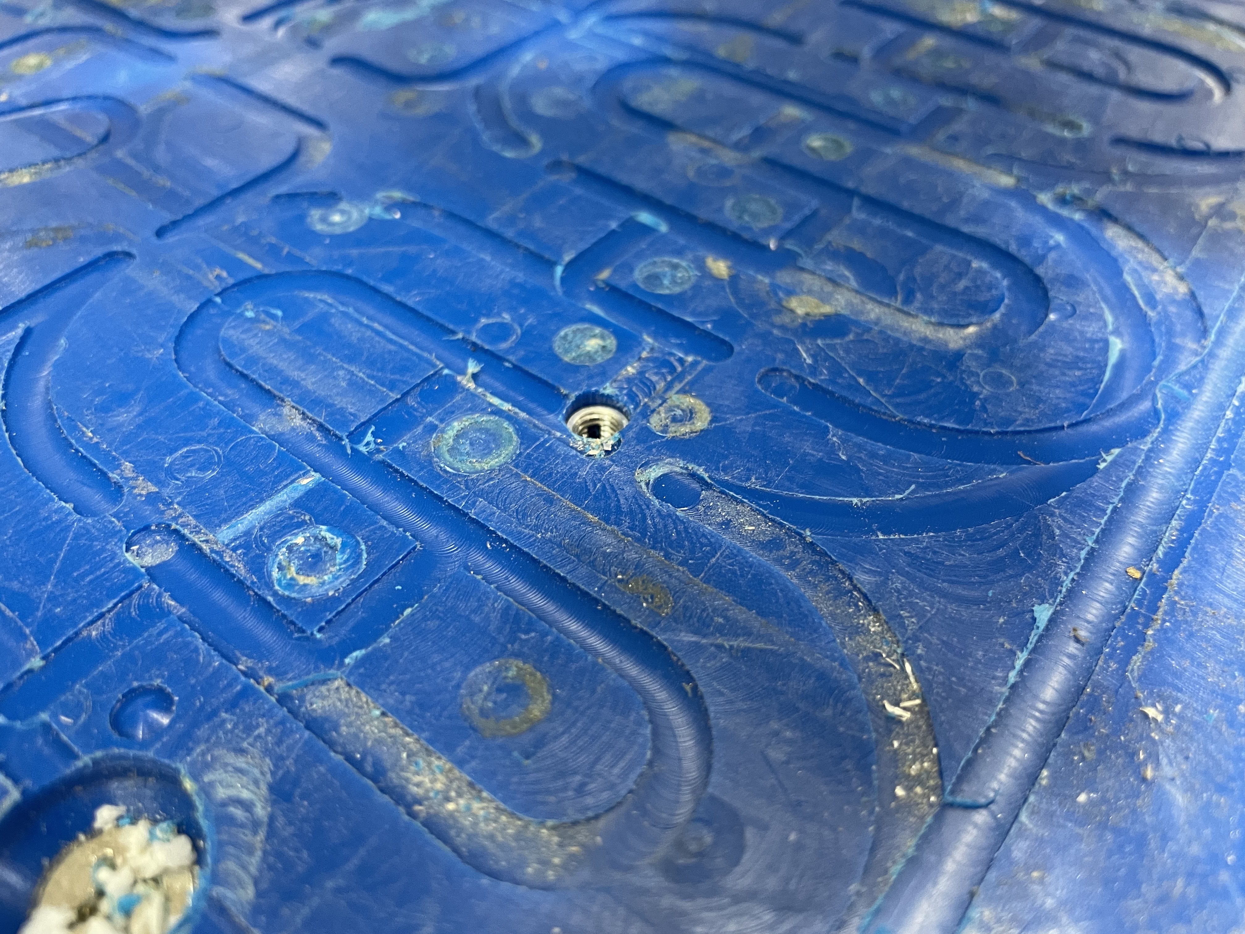

Thanks, that sounds like a great idea! How do you ensure the piece is straight when clamped in like this?
great question, as i mentioned a few posts ago we have several dowel pis we put into the spoil board and we know that they are parallel with the spindle, these pins are what we use to get our precise straightness and then we can adjust for any variance in the cams by clamping more or less because each cam is independent of the others.

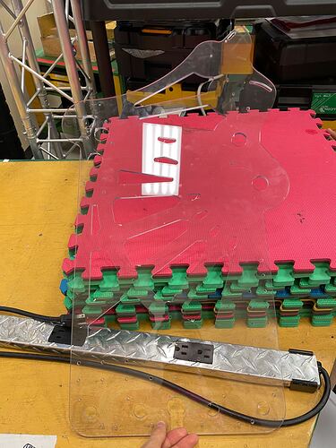

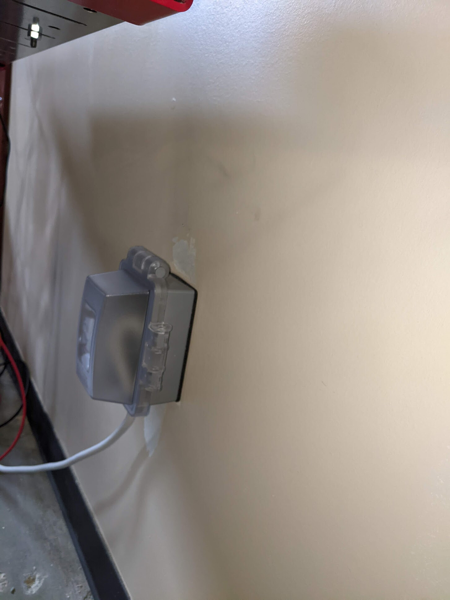

  1. installed an outlet cover for the CNC router. We had covered it in electrical at some point because the outlet we plugged the router into is directly underneath the router. Early on, we kept tripping the breaker as little shavings of metal would get between the prongs somehow.

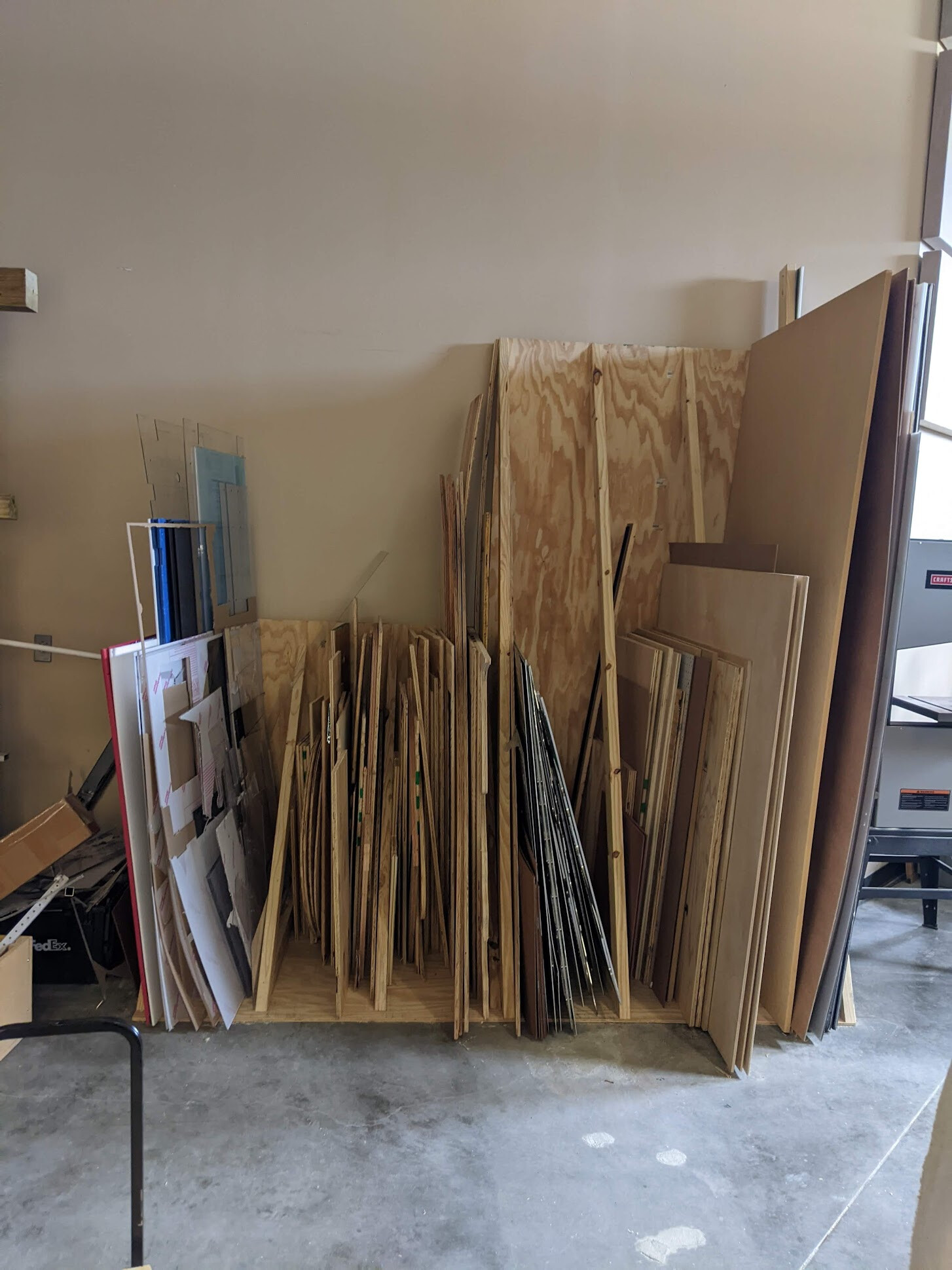

  1. Some students went through and reorganized our sheet stock! Looking much better. Instead of sorting by material type, we now just primarily sort by size.
  2. got a couple more tables built and painted
    Still need to install the shelves for the sterilite bins on them
