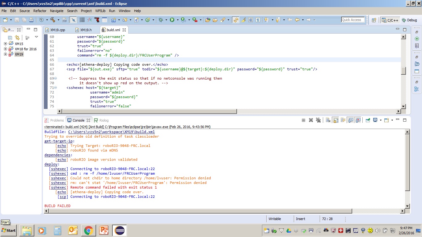

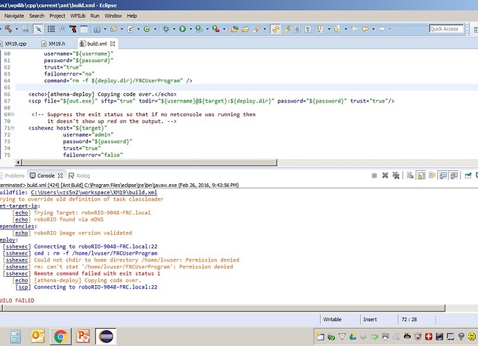

I just received this issue after updating (repeatedly) the firmware and image on our practice robot RoboRIO. I tried your fix but it did not seem to work. Please see below for a screenshot of the errors.
I know at least a few others on CD have reported similar to identical “permission denied” errors. I am not a hardcore programmer at all, so pretend I’m very unfamilar with Linux and SSH and all that jazz and please help me (and others) diagnose this problem quickly. Thanks in advance for the prompt assistance!

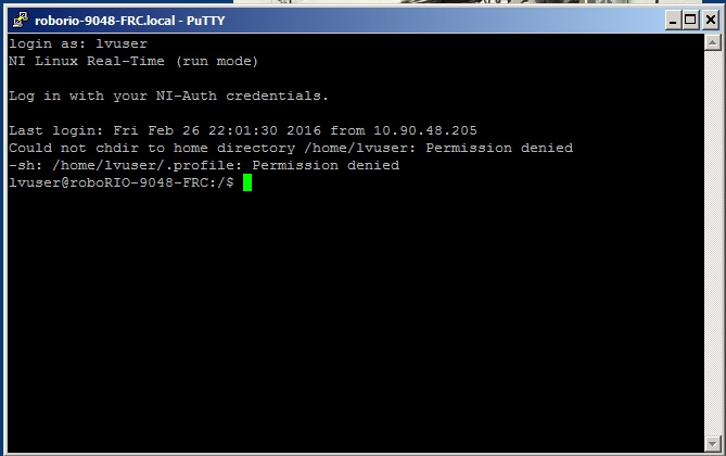

EDIT (twice…) - I was able to log in to the roboRIO using PuTTY and the admin login. I was also able to login using lvuser, but when I did, I got the same “permission denied” errors upon typing “lvuser” and pressing enter. See the other screenshot below.
Is there any chmod command or other such magic that can be employed against this impenetrable directory stronghold? Help me toss 8 boulders at this thing.
And please don’t tell me to reimage the roboRIO without giving me a valid reason why I should. I’ve done that already. :smiley:

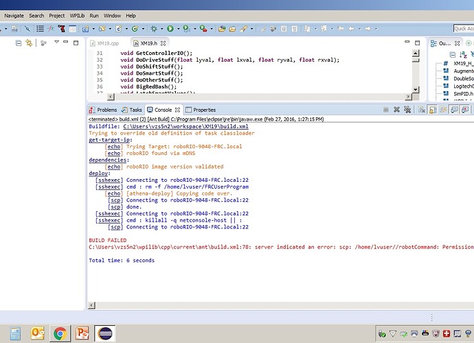

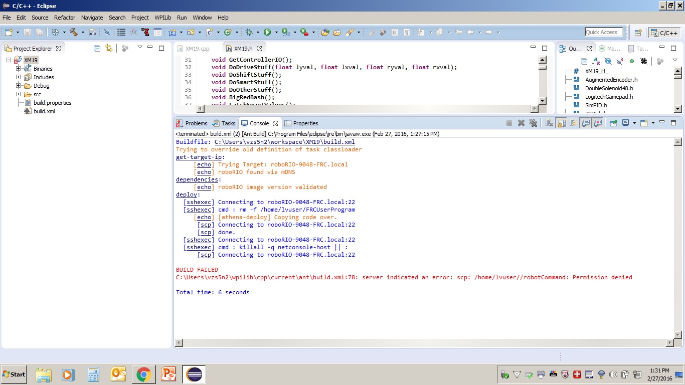

Just for fun, I got the roboRIO off our 2015 competition robot, updated the firmware and imaged it EXACTLY per the instructions (i.e. how I did everything before), and I’m still getting permission denied error. This time, however, it seems to proceed to the “kill all” part of the deploy routine before faulting. See attached, updated screenshot.

If you’re familiar with Linux, could you try ssh-ing to the roboRIO as lvuser and check the permissions and ownership of files in the lvuser home directory and look for anything not owned by lvuser. It seems like somehow something is getting messed up, maybe a a download failing part way through or something.
If not, I would expect that reimaging and being sure to check the reformat box in the imaging tool would get you back. If you do that, be sure to reinstall Java if that’s the language you’re using.
Brad
We SSH’d to the roborio as admin, then did
chmod -R 777 /home/lvuser/
To give all users read, write, and execute permissions to the folder.
lvuser was not the owner of the /home/lvuser/ folder, to we gave all permissions to everybody.
Its now working for us.
