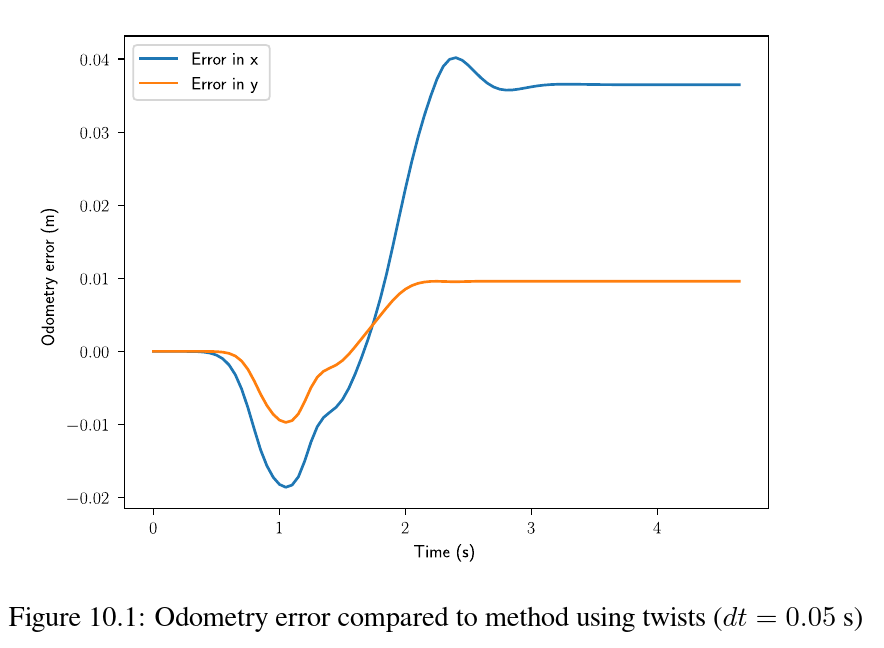

I think you missed my point. The pose exponential part of the odometry classes specifically is just as general as what you wrote because it’s working with the chassis movement instead of the wheel movement and it’s more accurate (it approximates with circular arcs instead of line segments).
For a curved trajectory, you’re looking at an integration error of 2 inches over a 6 foot run, which isn’t negligible. Here’s an old script I wrote demonstrating it and the figure it generates (to be fair, I labeled it poorly; it shows relative error of euler integration compared to twists).
Using position measurement deltas instead of velocity measurements helps cut down on the noise floor a lot, which is why we transitioned swerve odometry to that for 2023 (differential drive odometry was already using it).

2 inches over 6 feet is negligible if you’re also using vision measurements, though it is admittedly more that I expected. I just think that between noise in the vision data and the occasional loss of traction of the drivetrain the extra 2 inches of precision will be lost regardless. The next paragraph explains why my method can potentially be more accurate in accounting for the loss of traction with the accelerometer.
