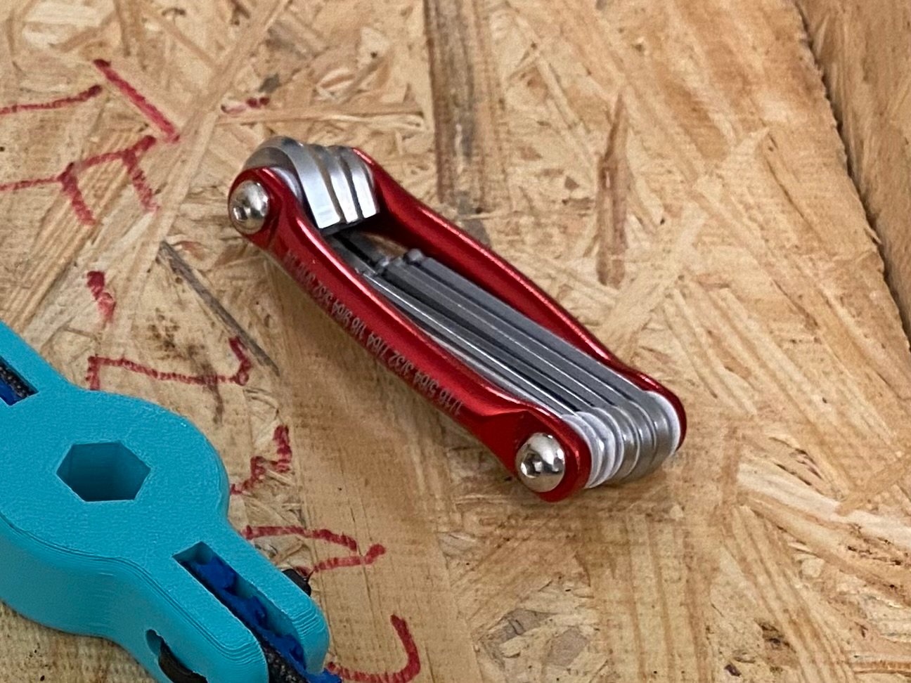

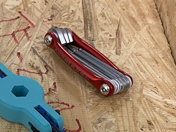

as a student I once wore folding hex key sets, 2 pocket knives, a leatherman, a pair of calipers (in a custom leather holster), and about 20 zip ties on or around my belt. Don’t be like student me. Now I have a leatherman wave+, a folding scalpel pocket knife, and a folding hex key set, and leave everything else in the tool box.

If you really want to make a practical set of tools to keep on your body for emergencies or helping other teams in their pits, get a multi hex set (all metal), a good multi tool (cheap multitools are almost never worth it), and a knife with disposable blades to keep your self from abusing the multitool. Safety wire spools can be worn on a belt and, with wire twisting pliers (back pocket), safety wire can fix many things.

EKLIND 20912 Steel Handle Fold-up Hex Key allen wrench - 9pc set SAE Inch Sizes .050-3/16 https://a.co/d/avGSgKh

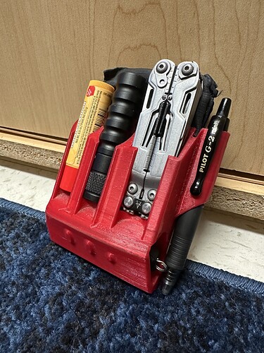

Not a tool belt, and not at all FRC-specific, but I’ve been iterating this pocket organizer just for everyday carry.
It holds my wallet, car keys (with buttons I can press externally), a pen, chapstick, a flashlight, and a multitool. The flashlight and multitool are particularly useful at comps, and I usually swapped the pen for a mini sharpie then too.
It also left room in my pocket for a little flip out allen key set as well.
This was all enough for pretty much any basic maintenance work on the robot (bolt tightening, cutting zip ties, etc.) that I had to do at comps. And it’s surprisingly easy to carry, given the stuff it holds.
