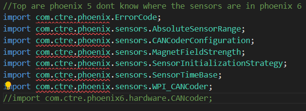

Hello. We migrated our 2023 project over. Installed the libraries. But lots of errors. Will start with: Where are the sensors in phoenix 6?
Thanks. I looked there. I can’t see where sensors would be in Phoenix 6.
I did find phoenix6.hardware.WPI_CANcoder; but I can’t find any of the other ones… absolute sensor range, configuration etc…
Here’s is a link to their API docs (which is linked off the migration guide page you read already).
You can search for each thing you need and find what package it’s hiding in.
For example, that CANCoderConfiguration says at the top it resides in com.ctre.phoenix6.configs
Thanks. Appreciate it. Is there anything I can enter the Phoenix 5 into and get the Phoenix 6 equivalent? For example, I cant find MagneticFieldStrength. and AbsoluteSensorRange still comes up as error?
Not really. You need to figure out what you needed from the packages, and see if it’s still needed in Phoenix6.
Phoenix6 has a much different API, not everything that was there is there still.

Lets ask a different question. Why are you using MagnetFieldStrength? Can you delete it? That seems like a pretty niche feature that seems surprising that someone without a lot of experience would be using.
Did you copy and paste code from somewhere else? Did wherever you got the code from already update for Phoenix 6?
MagnetFieldStrength was renamed to MagnetHealth, and the type for AbsoluteSensorRange is AbsoluteSensorRangeValue. All the enum types in Phoenix 6 can be found in the API docs for the StatusSignal getters and the configuration objects.

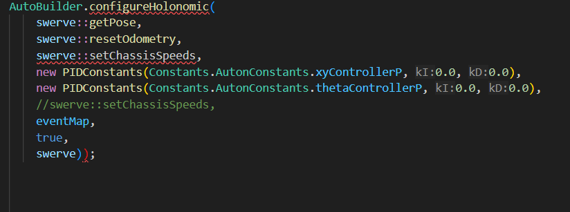

Thanks everyone. Been chipping away at this. Worked through this. Right now the biggest hang up is pathplanner. Tried setting it up with Build an Auto | PathPlanner Docs
no matter what I do configureHolonomic is not reconciled.
Your method call doesn’t match the signature in their API.
Their documentation is pretty solid, and they provide example code that you can use as a reference.
Thanks. I used their sample code. Still can’t seem to reconcile the configureHolonomic. Do I need to do anything here ?
In your code, you need your arguments you’re passing to match what is expected.
Here is the sample code in their documentation:

Your code you posted looks different.
Notice specifically, before the PID Constants get passed there is a driveRobotRelative method and then the PID config. Your code doesn’t do that.
Here is the link to the actual example code they have in github, with the Autobuilder.configureHolomic() call.
You should try to make your subsystem look like their subsystem so it will behave similarly.

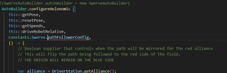

Awesome. Thanks so much for taking time with these questions. That cleared the configureHolonomic… which we were really stuck with. I noticed the linked code is different to the one posted. I copied the linked code in
Constants.Swerve.pathfollowerconfig, shows an error with Swerve
Actually it is not the swerve but the pathFollowerConfig,
Their code has a Constants file, with a static class named Swerve, that has an object called pathFollowerConfig.
If you don’t have that, you’ll have an error.
Ok. Thanks. Appreciate the help. We were really stuck. I put the static class Swerve into our constants file. But pathFollowerConfig still does not reconcile.
Put your latest code in Github or somewhere, can’t really help much more without seeing it.
