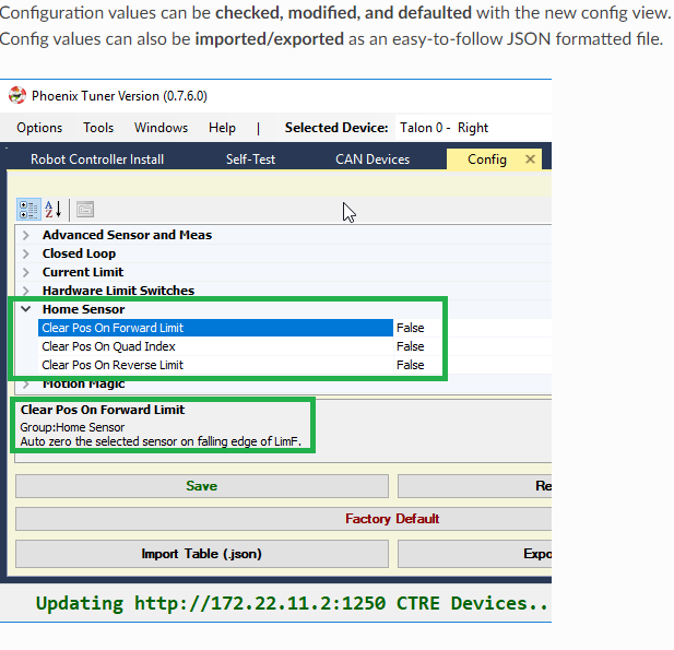

By key, I’m saying that each line in the config is a (key,value) pair. So “Clear Pos On Forward Limit” would be the key and the value would be “false”
Gotcha, that makes sense.
However, neither TalonFX nor TalonSRX have motor invert on that page. I just plugged in a Talon SRX, exported the config json and searched it for “invert” to double check.
So maybe you’re misremembering what’s available on the config page from SRX, or mistaking it for a similar term, such as Auxiliary PID Polarity.
