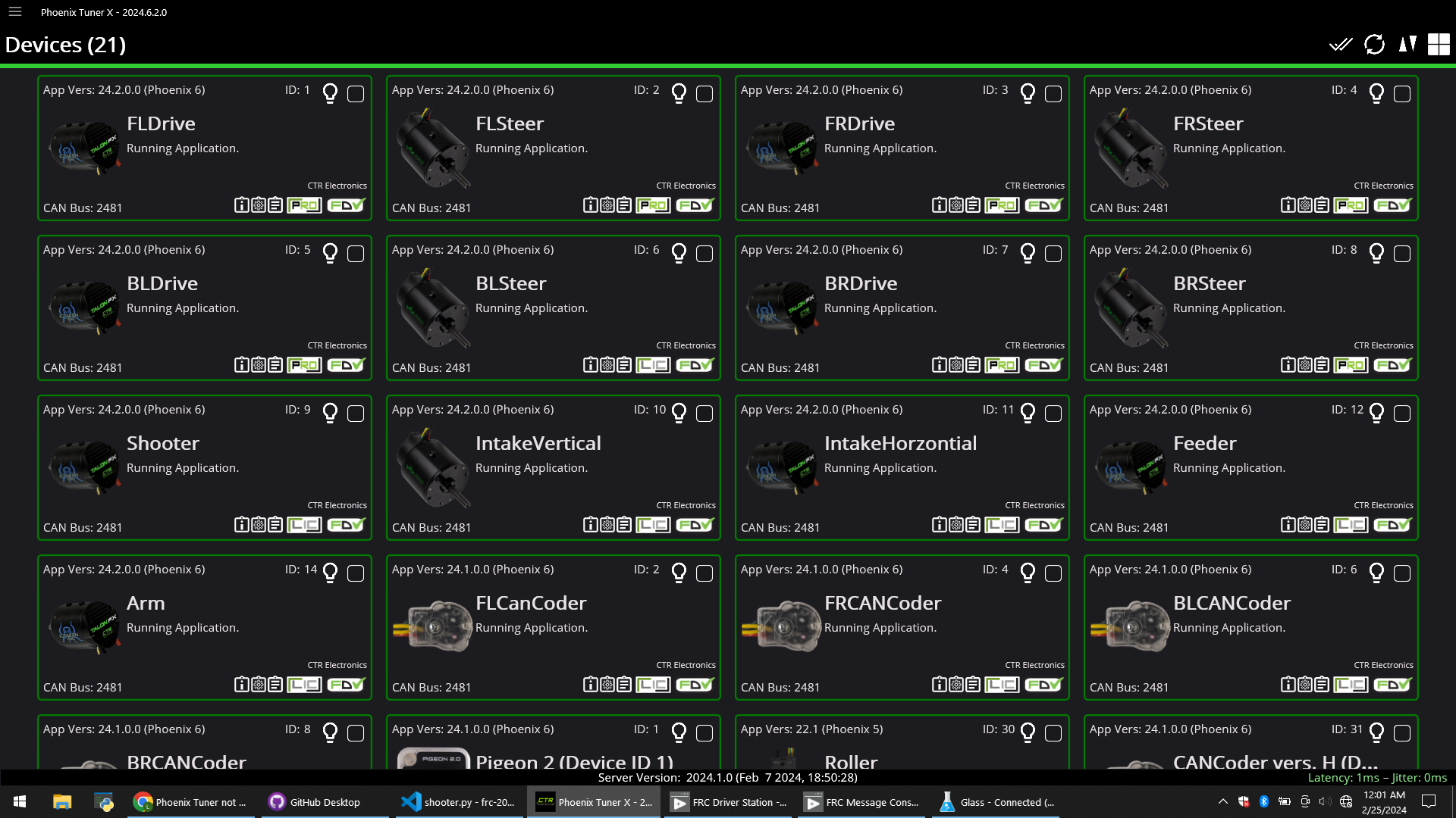

When using Phoenix tuner with a Phoenix 6 CANivore bus and a Phoenix 5 Rio bus what determines which bus Tuner will show devices for. Often time we don’t see our devices for our Rio bus. The compressor is working correctly so we know the PCM is on the bus. Tuner just doesn’t show it.
Can you take a screenshot of the Tuner page? How are you connected to the roboRIO? Can you connect to the robot in Driver Station?
I’m not at shop right now. We just realized this is a bigger problem. When tuner doesn’t see the devices our code errors trying to access them too. We restart robot code and it generally brings them back. It works more often than it doesn’t but it is by no means reliable.

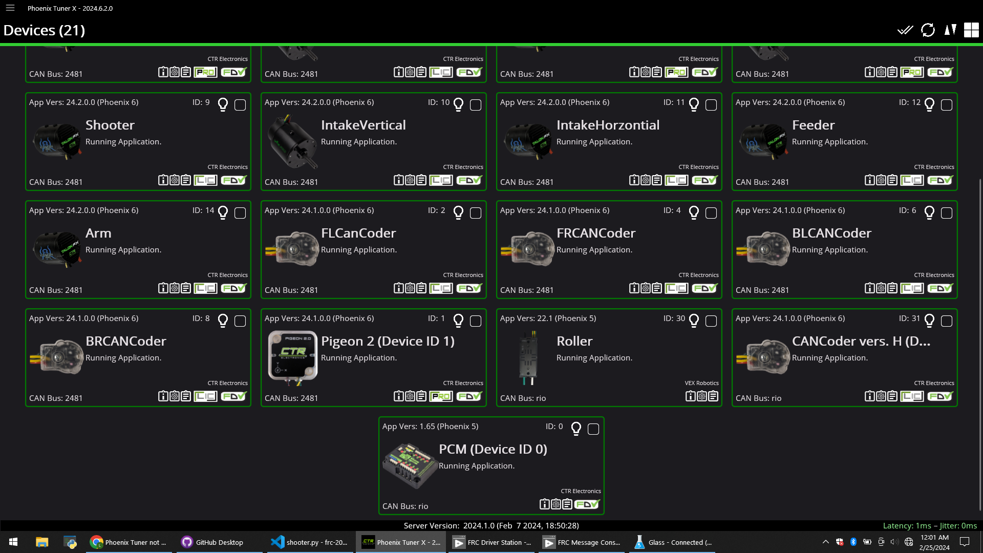

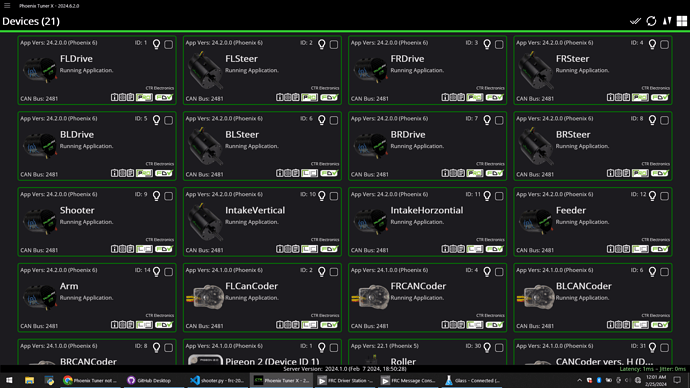

Creating a single device on the CANivore bus and applying a config is enough to reproduce the problem. We typically have to restart robot code 5 or more times to cause it to happen. If we add additional devices then it can generally happen after 1 or 2 restarts of robot code.
When it works we see all 21 devices when it doesn’t work we only see 18 and the rio devices are greyed out.
