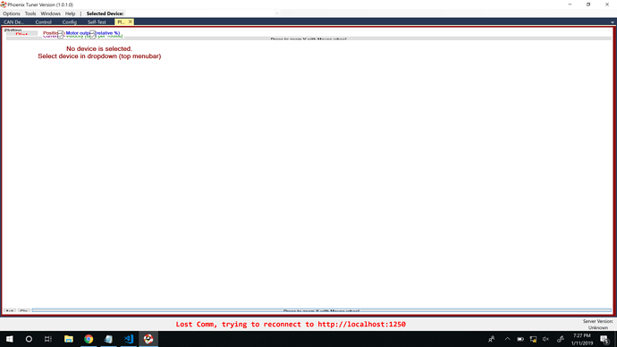

Does anyone else’s Phoenix Tuner look like this? I’m working on a brand new laptop (Lenovo Yoga) so I doubt it was anything I’ve done. Thanks in advance.
Its an issue with high dpi (>150%)
https://phoenix-documentation.readthedocs.io/en/latest/ch21_Errata.html?highlight=resolution#phoenix-tuner-is-odd-at-higher-display-resolution-dpi
  1. Updating will improve it…
    https://phoenix-documentation.readthedocs.io/en/latest/blog/blog-week1.html
  2. Or reduce monitor resolution closer to 1920 X 1080

I finally got around to working on that and the resolution change fixed it. Thank you
