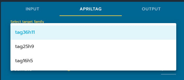

Running v2023.1.1-beta-6 but can’t seem to select the 16h5 target family, the only option is 36h11. I thought this version supported the lower resolution tags, what am I missing?
2022-12-21_14-30-48
On Settings tab, what does it show for version?
Can you do control + R to do a force refresh on the webpage? Haven’t seen this before.
I never would have thought Ctrl+R would have made a difference after powering down the LL and rebooting the laptop at least 3 different times, but it did. Thanks a lot for the help!!
