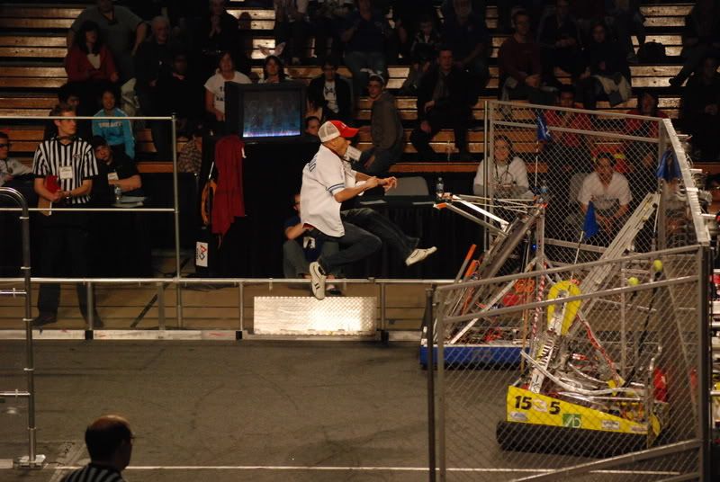

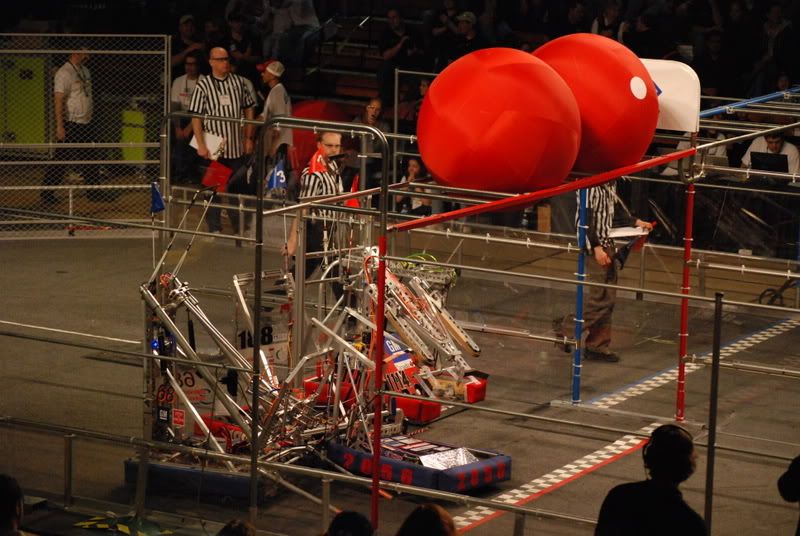

Blur is not a bad thing! Pic1] Pic2]Pic3]Pic4]Pic5] We perceive it to convey motion, or to draw your eye to the area of attention. Turn it from being a detriment to an asset by using blur to convey context and liven up your picture.
Some times you do want a rock solid shot of the field with the robots on it. You can accomplish this with any camera, but you may need to make some concessions to live within the capability of your camera. Knowing that motion causes blur, take your shot when there is not motion! For example, right after the match ends but before the judges go out on the field and the drivers leave their post take your shot while the machines are not moving. Someone casually looking at the photo would not be able to guess that the match is already over. Pic1] It is a little bit of smoke and mirrors, but remember that you are going after the shot and only you need to know in what context it was made.
There are things that you can do to minimize the amount of blur in your image. The source of blur can be your subject or you. Make sure you are holding your camera rock solid when you take your shot. You could try to use a tripod to help you keep steady, but I hate them. Tripods do not work well with as many people at an event as FRC and no one paying attention to where they are walking. You also want to be mobile to get around as quickly as the fast paced game itself. A tripod will only slow you down. Get creative. Set your camera on a trash can or rail to stabilize your shot. (This was after the event, I sat the camera on the stairs to leave the shutter open longer. Pic1]) The one trick I use is I wrap the neck strap under my arm and make it short. Then when I lift my elbow to take the shot the strap tightens and I can use my entire upper body to stabilize the camera. With a pocket camera I sometimes hold it against my forehead to keep it from moving. If you have two hands on it and it is out in front of you to look through it is not easy to keep it still.
Take your shot when your subject is not screaming down the field such as when the machine is hurdling Pic1] Pic2] or sitting at the starting line. Pic1]
