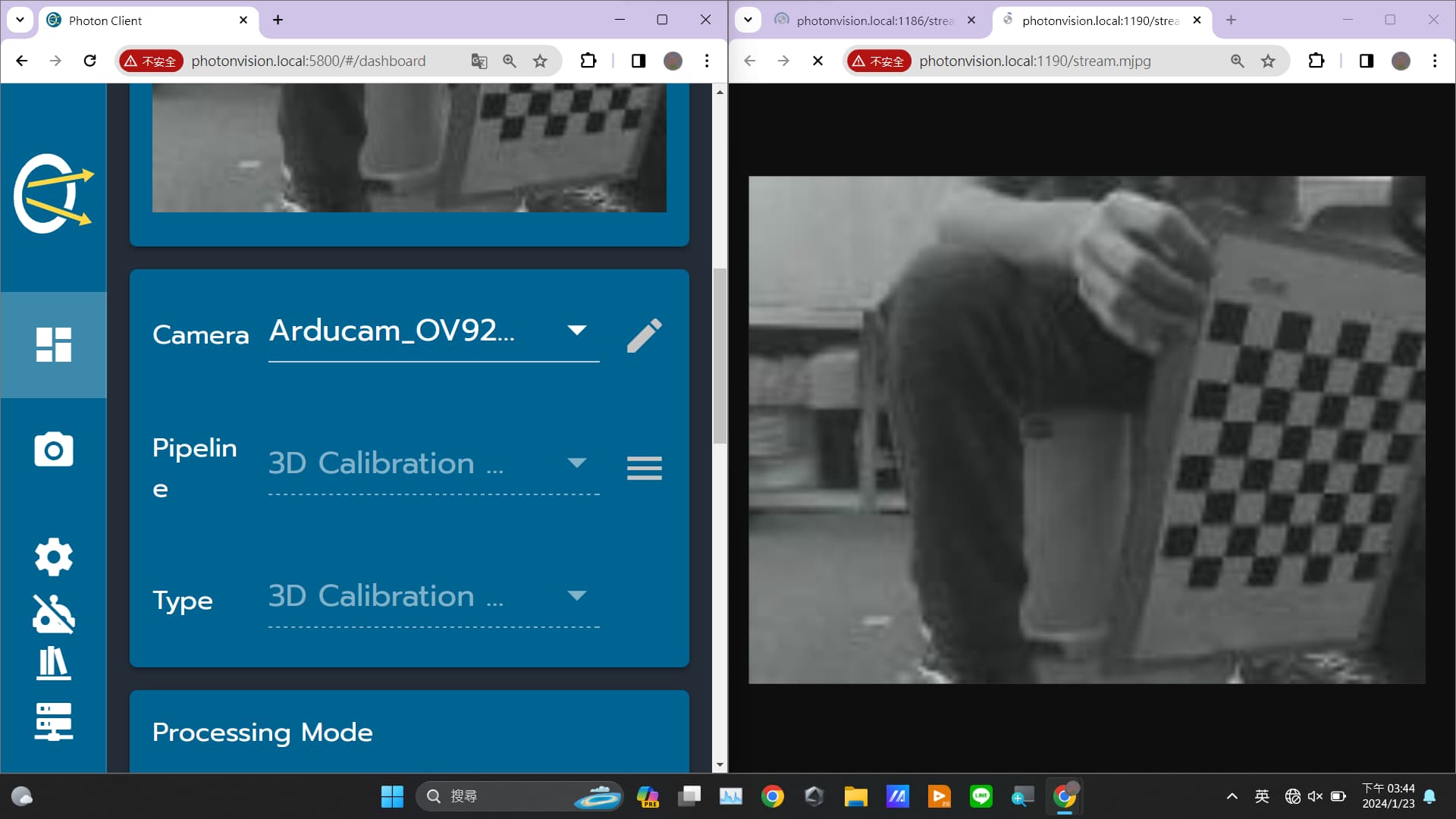

Initially,we used web cam to calibrate AprilTags,and after that ,we tried Arducam do same thing,but its type and pipeline are stuck on 3D calibration.How can I deal with this ? Please give me some instructions!!! Thanks.
螢幕擷取畫面 2024-01-23 154426
Under the cameras tab in the calibration card, did you click finish/cancel calibration? Looks like no
When i start to calibrate,all of sudden, the type changing like this,so ,we didn’t start calibration…
before i started calibration , i have changed pipleline and type to Apriltags
but when i pause the button which taking picture , pipleline and type turned to 3D calibration, and it is useless pipleline and type
