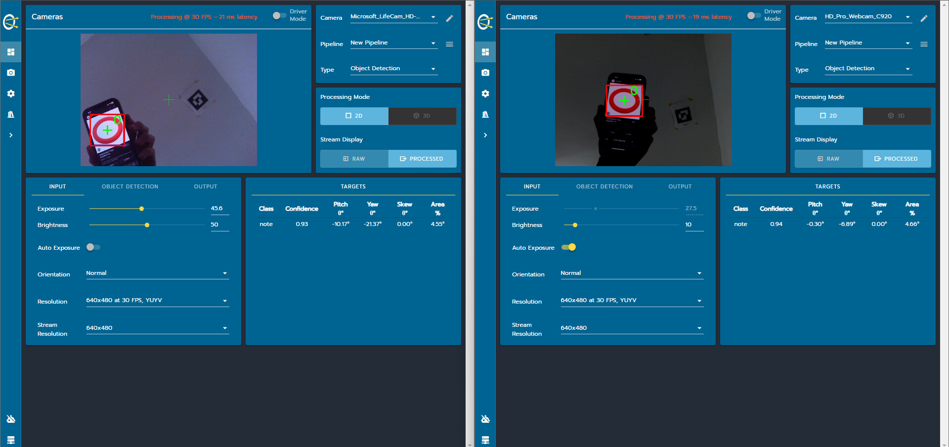

And that same PR working on my âââCool Pi 4bâââ with rk3588s ($120 on Aliexpress rn)! This is with dual cameras (Logitech C920 and Lifecam HD-3000) over a gigabit ethernet switch directly to my windows laptop, exposure/video mode settings in the screenshot. I was able to get it working without too much trouble, but the Opi5 is already ubiquitous and better supported.
