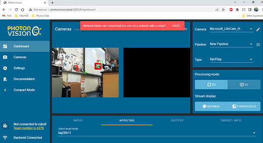

Up and running
Any setup feedback?
BTW Threshold view is just unused, so you can hide it.
How’s performance with and without pose estimation? (assuming you have with pose estimation set up)

I have only gotten it setup and then took that screenshot. I have done nothing with trying to get or send data… that’ll be up to the kids.
Setup: imaged using BalenaEtcher (already had from Limelight), no problems. Pi3b with a 32GB microSD.
Ran an ethernet cable directly from the pi to my laptop, turned off wi-fi, went to the photonvision.local:5800 address and it popped up in retroreflective mode. Switched to Apriltag and what you see is what I got.
Pretty painless. Only hiccup was I didn’t have a modern keyboard to plug in, so I used an old G4 iMac (clear plastic) USB keyboard. Worked perfectly.
Why did you need an external keyboard? You shouldn’t have to use one for imaging.

I guess I didn’t?! I thought I had to log in to the pi. I’m a mechanical/cad guy. Teach physics. The Pi’s functions is dark magic to me. But I get GUIs. :grin:
Well, I’m glad our non-computery comrades don’t have trouble with the setup. Just what we like to hear.
