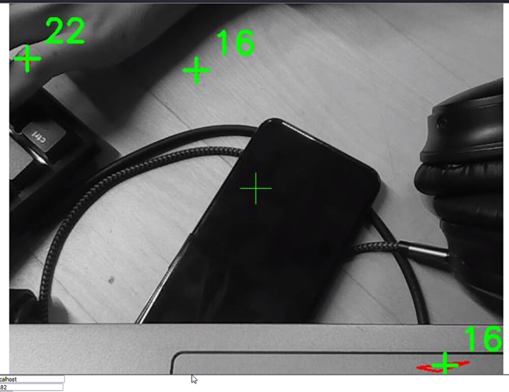

How’s your false positive rate?
So far, in my basement workshop, non-existant. More testing to come.
Setting a threshold of 0 for hamming distance (how many error bits were corrected) for this tag family might be a good idea to help reduce false positives, as there’s simply not as many error correction bits available.
Part of the reason I may not be seeing false positives is not that they’re not there, but in my filtering for specific tags the false positives may drop out. For instance, I only search for tag ID #5 in the results.
That totally helps, yeah. At least for me…
Working on testing hamming distance limiting now as well

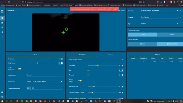

Did someone say max error bits and decision margin sliders in a new photon beta?? Also 16h5 support
(Edit) to expand on the above: max error bits is the max number of bits the detector needs to correct in the tag, 0-1 seems good for 16h5 because it’s so small and so there’s so little info to reconstruct from. Decision margin cutoff changes how much “margin” the detector has left before it rejects a tag; increasing this rejects poorer tags. Without it, this happens lol
