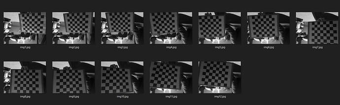

Now, we’ll capture images of our chessboard from various angles. The most important part of this step is to make sure that the chessboard overlay matches the chessboard in your image.
But at some resolutions and angles the rainbow overlay didn’t match at all well.

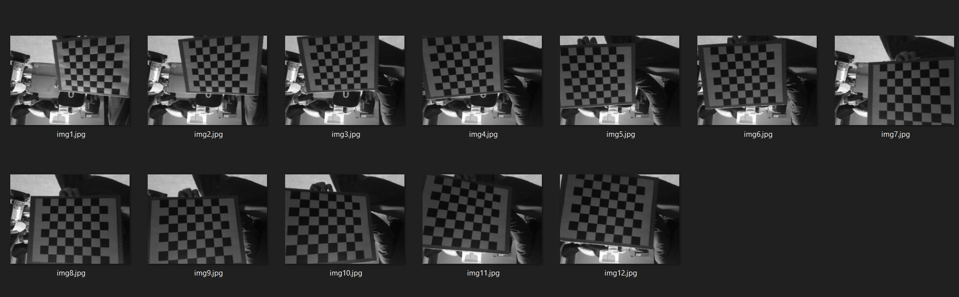

Definitely make sure the overlay matches.
You want to get images of the chessboard to collectively cover most of the FOV as well as the chessboard with minor tilt if possible (not completely parallel to the camera).
If the reprojection errors are low, you will have a smaller mean error/standard deviation. This doesn’t mean the 3d measurements will be accurate, only that the calibration model fits the given data (check your physical checkerboard dimensions are accurate).

Proper calibration yields excellent results.
I had not noticed on the Camera Calibration that the yellow bar at the bottom was a scroll bar; I thought only the mean error and std dev were the only two columns and that was reinforced by you pasting that in #13 above.
Before proper calibration and now capable of scrolling I see the FOVs were ridiculously low. I followed your instructions and the FOVs are now exactly the published numbers. The x, y determined distances are pretty good now. Thanks for your instruction.
