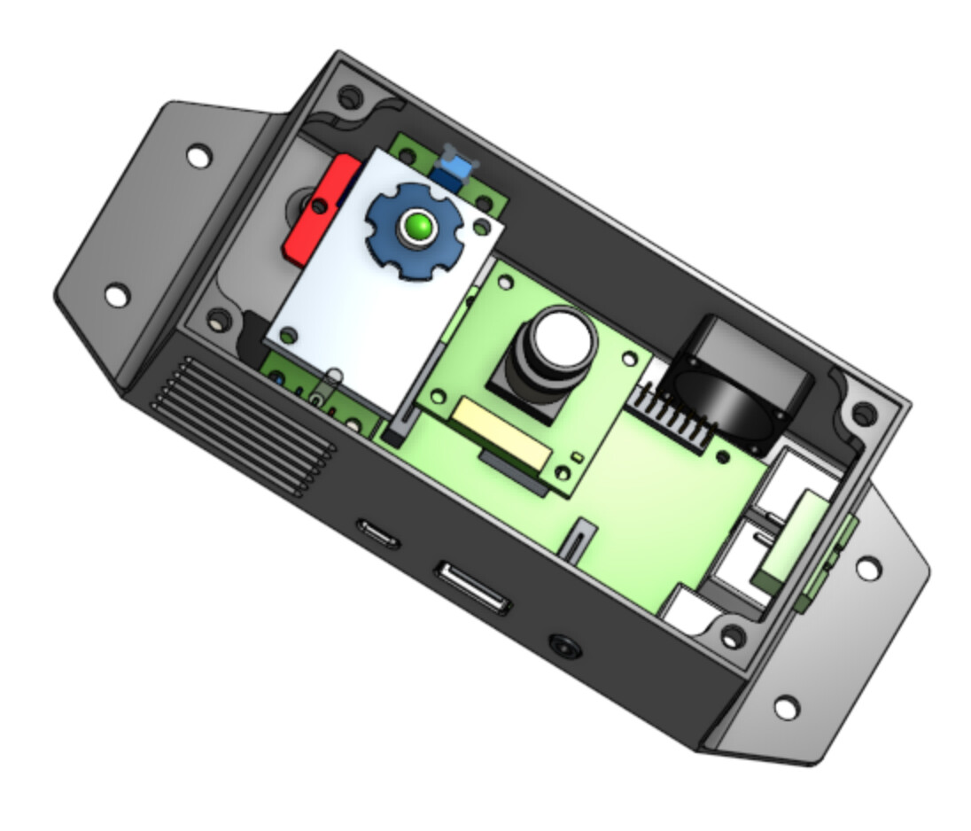

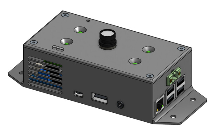

I’ve been working up a case to integrate numerous off-the-shelf components into a usable vision module for PhotonVision for teams to make use of. It’s slightly larger than a Gloworm or LimeLight but not overly so (that’s what the price of using off the shelf modules is).
I’m working on the assembly notes as I assemble the first batch of 4 “final” versions but the CAD is available at Onshape
There are reasonably complete BOM notes for non-obvious components.
It uses 4 1W green LEDs (typical eBay and Amazon stuff) similar to the Gloworm configuration.
I have a lot of the assembly notes written up and if I get a chance, I’ll make them available as well - probably via a github repo.
I was planning a more public release but got sidetracked building a new 3D printer - a 350^3mm Voron 2.4 - that is a cool deal.
Just be sure you have a circuit in there that allows the LEDs to be PWM controlled from the Pi :slight_smile:.
4 watts is a lot of light.
Also, if you take the input of your buck regulator from the Pi’s PoE pins, it will work from 12V passive PoE. Saves a wire.
Oh yeah - it’s PWM’d. WIth a user-accessible trimmer for modest +/- mechanical adjustment brightness adjustment - figuring it’s easy to get someone, just about anyone, to make a minor brightness adjustment in <5 seconds as opposed to making a Photonvision dashboard adjustment (which likely can be done only by a more specific subset of team members).
I consider the LEDs to be 1 “eBay watt” - which in my experience is quite different (but still bright).
I think there might be an update to the final doc regarding PoE support :wink:
