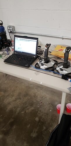

My team is making one. The electronics end of things is finished, but it still needs a bottom and handles.
