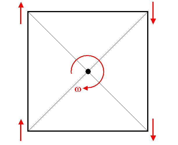

***Assume the following:
  • skid-steer vehicle with 4 standard non-treaded wheels
  • square drivebase: trackwidth = 2 ft, wheelbase = 2ft
  • coefficient of kinetic friction 0.7, independent of speed and direction
  • center of mass 150 pounds is located at center of geometry
  • left wheels being driven forward at tangential speed 2 ft/sec
  • right wheels being driven backward at tangential speed 2 ft/sec
At steady state, how fast is the robot rotating?**
I’m not sure how friction factors into this. A really wide wheel will have much more turning scrub than a thin or donut shaped wheel.
Here’s what I’ve got so far:
I broke the wheel velocity into two components, one in the direction from the wheel to the center of the bot, and the other perpendicular to this one. The inward pointing one is all lost to friction. The other one has a magnitude of 0.707 * 2 = 1.414 feet/second.
The distance from the center to the wheel is 2.828 feet. This means one rotation is 2pir=17.768 feet. This means it’s rotating at 1.414/17.768 = 0.079 rotations per second.
I think I’m missing something eight the friction.

Given the assumptions in the problem statement, the answer is 1 rad/sec.
The wheel radius times the wheel radians/sec, tangent to the circumference of the wheel at the contact patch, in the plane of the wheel.
At steady-state, the net torque acting on the bot around its center of mass must be ZERO.
The only forces acting on the bot in the horizontal plane are the four friction forces (one at each wheel). The direction of these forces will start out aligned with the plane of each wheel, but will change as the robot begins to spin. Given the assumption about CoF being independent of speed and direction, the friction at each wheel will always point in the direction of the relative motion between the carpet and the wheel at the contact patch. This relative motion is the vector sum of the wheel tangential speed plus the carpet speed at the wheel due to the robot’s motion.
When the robot spin reaches the point where the net torque around the center of rotation is zero, the spin will stop changing.
The robot weight (150 lbs) and CoF (0.8) were red herrings. Given the assumptions, their values do not affect the answer (as long as neither is zero).

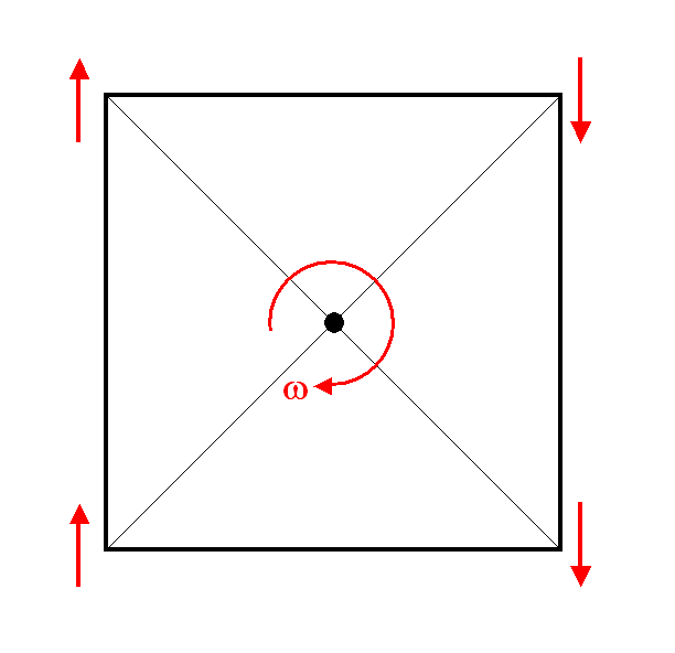

Now, assume the drivebase is rectangular instead of square:
wheelbase = 2 feet, trackwidth = (28/12) feet. Everything else the same.
.85 rad/s
The rotation speed will be achieved when the net torque on the robot becomes zero (after it was non-zero while the robot is initially accelerating). Also, there is only one force coming from each wheel, the frictional force provided by the carpet on the wheels. Therefore, the only way bring this force to zero (since it has a non-zero magnitude) is to have its line of action be in line with the center of rotation. (such that cos(theta) = cos(180) = 0 in the torque calculation).
The frictional force will also be in line with the vector sum of the wheel’s tangential speed and the carpets speed.
Knowing the tangential speed of the wheel, the tangential direction of the robot’s spin and the direction of the frictional force at the wanted equilibrium, the speed of the robot’s spin can be solved for.

Take your value omega=0.847 rad/sec and use it to calculate the x and y components of carpet speed:
Vcx = omega*(L/2) = 0.847*(2/2) = 0.847 ≠ 0.988
Vcy = 2-omega*(W/2) = 2-0.847*((28/12)/2) = 1.012 ≠ 0.847
Now try omega = 84/85:
Vcx = omega*(L/2) = (84/85)*(2/2) = 0.988
Vcy = 2-omega*(W/2) = 2-(84/85)*((28/12)/2) = 0.847
