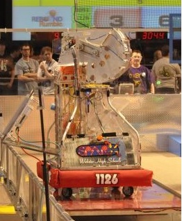

pic: 1126's 2012 Robot - Legacy X
Now that the 2012 Finger Lakes Regional has come and gone, I thought I might as well put this up.
Presenting Team 1126’s 2012 Robot - Legacy X, our 10th robot!
It’s not perfect, but it’s our tenth, and it’s very special to us.
(Sorry for the poor picture. If I can find a better one, I’ll put it up).
Some specs (To the best of my knowledge):
119.6lbs (will probably go down at champs)
4 wheel co-axial Swerve drive (4 CIMs, 2 Window motors)
Roller on wide side to allow for more intake
Funnels into polycord elevator
Pneumatic kicker sends balls to shooter
Shooter (powered by FP) designed to allow for maximum contact w/ roller
Chute in back to get from inbounder
Drop-down scraper to get balls off the side
Pneumatic slide drops down and locks to allow us to run into the bridge and drive right on.
Can score 2 balls on top in hybrid
From where we were sitting, it was not a bad robot at all. The dark horse of Finger Lakes I would say. We couldn’t have had the success we did without your robot and team. Get all the little bugs out of the system and you will have a force to be reckoned with.
Good luck to you all! 10 years is a great achievement in and of itself.
Thanks Evan! It means a lot. We were honored to be able to work with you guys in the elimination matches. I think it definitely has potential to be a good bot, and some improvement ideas are in the works.
However this season ends, it’s our 10th robot, and we’re very proud of the work we’ve done on it!
