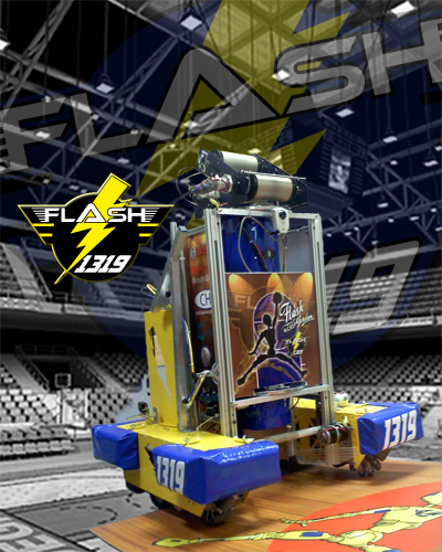

pic: 2012 Flash FRC Team 1319
Robot Name: Flash Jordan
Robot Specs:
MecaTrac Drivetrain top speed 17FPS & low speed 4 FPS
Wide bot config for easy ball pickup and less room occupied on bridge
Scoring section
Fixed shooter angle on 270 degree turreted shooter all riding on a 30 inch elevator made of Bosch extrusion.
Programming
Camera assist with all kinds of sensor feedback for ease of operation.
Includes pneumatic powered passive bridge pushdown arm with servo latch.
See you at Smoky Mtn, Peachtree, Palmetto and St. Louis.
Good Luck to all!
Drivetrain
• MecaTrac Drivetrain
o Meccanum Wheel Speed ~17 FPS
o Traction Wheel Speed ~4 FPS
Ball Intake
• Wide drive base allows for ease of ball collection
• 3 Ball Limited Capacity
Shooter
• Fixed 2 FP motor driven horizontal rollers w/encoder control
• Atop a 270 degree turret
Elevator
• Ball intake and shooter ride on an elevator to get closer to 3 point goal.
Bridge
• Passive wedge to lower bridge
Looking great Erich. Can’t wait to see you guys at Palmetto. Does the “MecaTrac” imply you are using that drop/rise center traction wheel design again? I heard what a pain it was but back in 2010 it was pretty cool.
MecaTrac is what everyone is calling Octocannum here on ChiefDelphi. We termed it MecaTrac when developing it for our use and it stuck.
Last year the only pain we had was if we had to take it apart and put it back together. This year we can have a module out and a new one back in under 5 minutes. Although last year we only had to replace a module before ship due to a gearbox being put together incorrectly after a gear swap, so we are very happy with the reliability and what it offers of this drivetrain.
