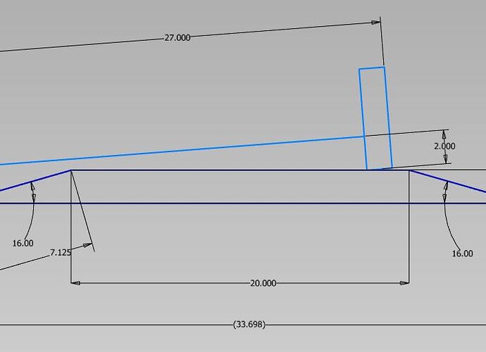

pic: 2015 WCD Clearance Considerations
It seems like 4" wheels will have their challenges this year. Am I missing something?
just to verify what is this exactly depicting a robot driving over the humps.
Seems like 6" wheels and 2" tube are pretty much gonna handle anything the bump can throw at it, which is nice.

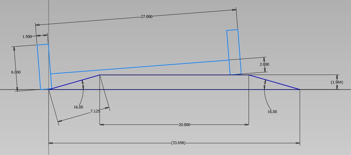

Apologies, I mis-clicked prior to finishing the description. This is a skid-steer robot represented from the front, as if the robot were driving down the white raised platform. The line going between the 1.5x6" wheels represent the bottom of the cross rails of a WCD (not including bellypan/etc).

Double-check that you’re comfortable with this 0.25" clearance:
http://www.flybotix.com/files/frc/2015/ClearanceConsiderationsSide.JPG
.25 is plenty, but mine will have a wheel or 2 between those two, so no problem. pretty sure 4" wheels would work fine too:)
in the first picture, those are 6" wheels which do not bottom out. 4" wheels definitely bottom out.
Depending on the length of your base, you actually can get away with 4" wheels traveling over the platforms. However, with a WCD, you’ll need 6" wheels in case you catch the corner of the scoring platform with the front of the drivebase or if you want to drive along the length of the platform.
In short, going with 6" wheels is probably the better option.

To clarify, it’s the trackwidth that’s the challenge, not the wheelbase. As mentioned, adding additional wheels easily solves the challenges with the wheelbase when you’re travelling perpendicular to the scoring platform. However, if you’re travelling down the length of the platform (or at more extreme angles towards the platform), the width between your wheels may cause your robot to bottom out if you don’t have enough ground clearance.
