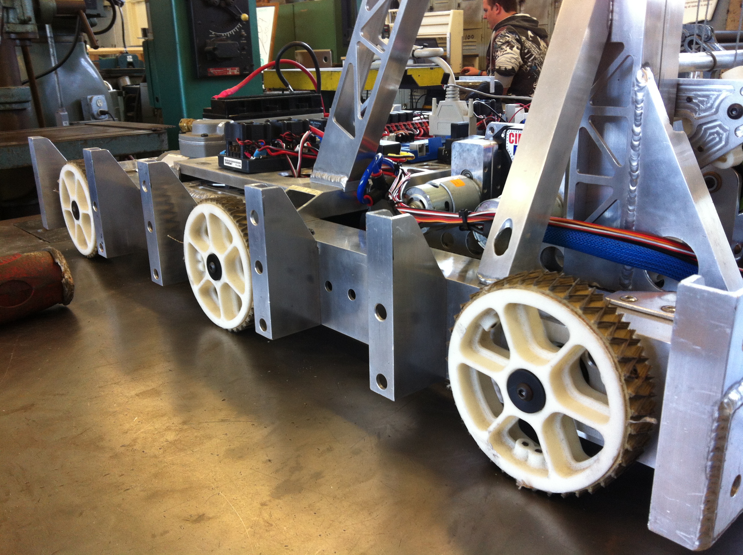

Our 3D printed Wheels, 2 seasons later.
In your experience, how well have 3D-printed wheels worked under stress? Have they ever broken in the middle of a match or anything like that?
This chassis had no issues at all, our 2012 chassis we cracked a few wheels when we hit the bump so we redesigned the wheel for the champs and they work like a charm. Even handled jumping off one of the bridges.
Did you just glue the tread to the wheel? From the picture, I can’t see any other fasteners. Also, what’s the life time on a printed wheel?
We designed three bosses into the wheel that was tapped for 10-24 button heads.
The wheels you are looking at have survived our 2011 season which was short and general practice driving even since. No cracks.
Our 2012 Champ version wheels have dings and gouges with not signs of damage.
What diameter wheel and how much did it end up weighing?
-RC
This set was 5" @ 6 ounces a piece.
What type of plastic is that and what type of 3d printer do yall have?
Sorry should have said this prior
We have a Uprint from Dimension that prints with ABS.
So I take it they stand up to sideways stress, ie getting t-boned? Were you able to easily cross the barrier multiple times? What about pushing matches?
Side loading and pushing had no effect.
Impact loads from hitting the bump across the open span of the spokes it what caused cracking. Just redesigned and never had an issue. We we able to hit the bump at full speed and pop right over it.

Do you have pictures of this design?
Pretty amazing to think that you didn’t crack a wheel driving off that bridge.

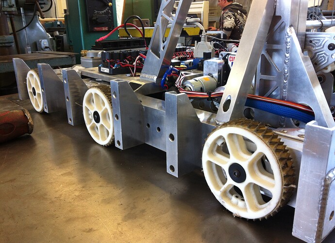

Here’s the link to the wheels. Our original wheels for this season were structurally very similar to the ones we used last year, the one you see mounted to the robot in this pic. I’ll drop in another interesting shot as well.
That CRio placement was a little precarious, but it worked out.
