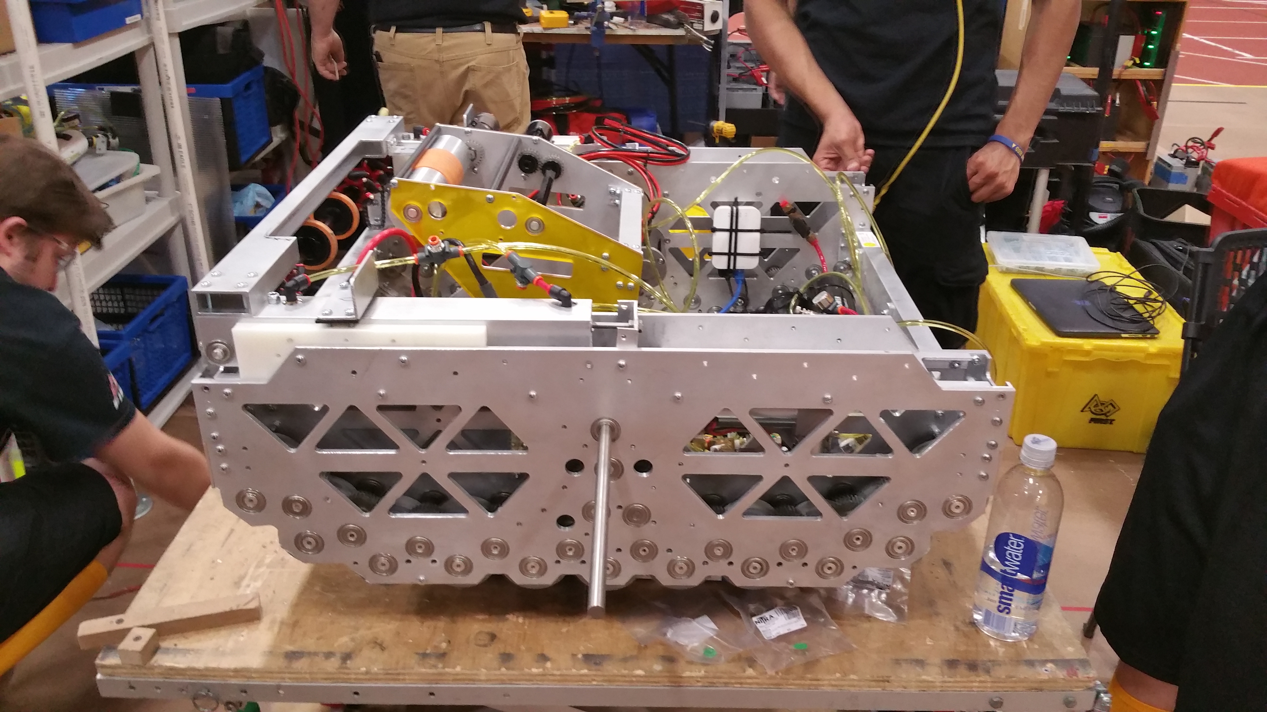

271’s 2016 Robot for The Blue Alliance

If I counted this correctly, I see 100 bearings alone in the drive train… WOW!

96, 4 are for our shooter :slight_smile:

Ooooh that’s pretty. Glad you guys have everything ready for Sbpli. If you need any help I’ll be floating around all 3 days (running the livestream). $500 for just bearings :). How heavy is each module? Also how is the turn scrub? Do you have a wheel drop on the center wheel?
Thanks! Almost ready for SBPLI, working on our tweaks as we speak. The bearings actually cost us only like $1.50-$2 each or something like that since we ordered in bulk. I don’t have a weight on each module, but the entire base + all electronics is <75lb, there is 0 turning scrub, and the drop is 1/8 spread across the wheels.
