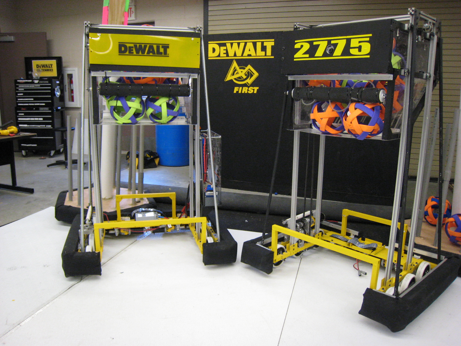

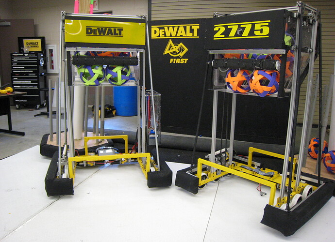

pic: 2775 twins ready to play.
Right before the one on the left was boxed and taken to St.louis. We look forward to seeing everyone there. Good luck everyone.

That’s a sweet scoring/collecting mechanism! How long does it take to bring the basket up/down?
It is about a second from bottom to top and the same going down.
I have to say that this is one of the most creative designs I have seen so far. I would have never thought of an elevator basket. nice job, and looks good to.
Thanks, after much testing we were scared of deformed balls and conveyors so this way we don’t have to deal with it. If the roller can pickup the ball in the first place it can spit it out the same way.

The basket can hold ~14 balls and as Greg said moves up/down in about a second and unloads in 4 ish seconds.
Sweet and simple I love it, how much range you get out of it?

the front roller powered by a FP during this video it will be changed to a cim for more range. Enjoy.

The one on the right is the competition bot and is sleeping in it’s crate for a few weeks.
The one on the left’s name is “shred” and the one on the right is known as “scarf”.
