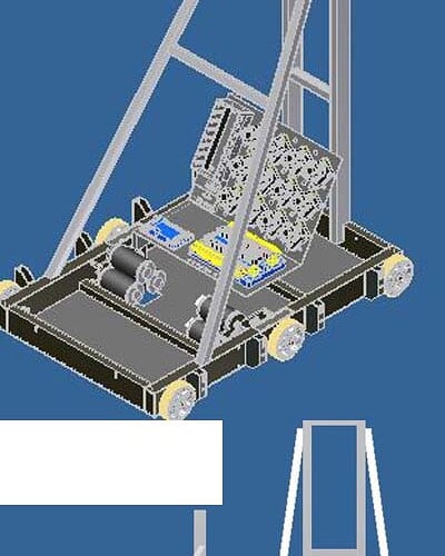

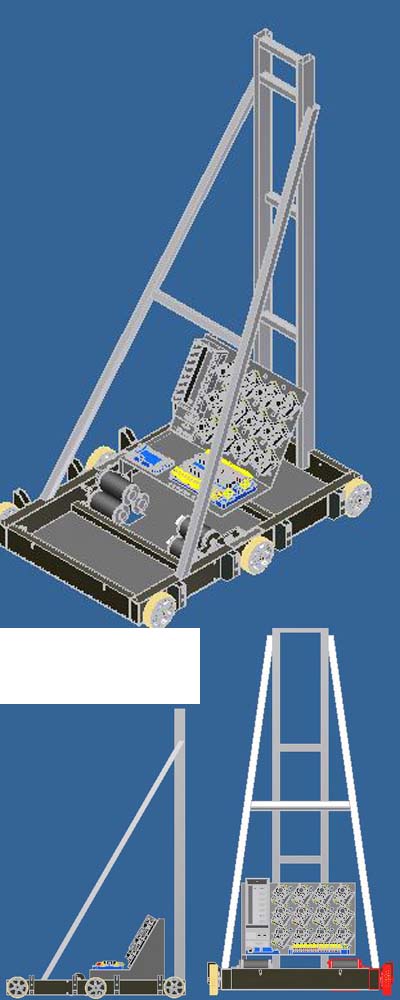

Please forgive the poor Photoshop Job. I am looking for a bit of advice. Although we have not nailed our arm manipulator design yet we want to be able to get the fixed upright welded when the rest of the frame is in the shop. Currently I have it drawn with 1/16" wall tube. The two vertical pieces are 2x1 the rest are 1x1. Do you think that this system will be strong enough to support a arm that can reach to the top peg and weights around 30 or less lbs? Is it overkill? Thanks.

Right now there’s no room on the arm pivot for a sprocket or anything behind the pivot point. I’m not sure how to fix this but it looks like as long as the long 2x1 pieces are mounted on the back like that it’ll be a problem.
see if you can get the arm to weigh 10 pounds or less…5 would be about right :slight_smile:
then yeah, it’s overkill…
Should be about right with 1.5" PVC and a roller claw.

Be careful of rule , It appears that you have three CIM motors on each of those drive gearboxes.
Motors specifically permitted on 2011 FRC ROBOTS include:
C. one or two additional 2½” CIM motors (part #FR801-001 and/or M4-R0062-12) in addition to those provided in the KOP. This means that up to four, and no more, 2½” CIM motors can be used on the ROBOT,
We have 3 CIMs in the model, but we did that just because there wasn’t a BB + CIMple Box model available while designing.
On 330, we put our mast back a few inches to allow room for a big sprocket at the top. http://www.chiefdelphi.com/media/photos/27675. We use 2x1 1/8" for the mast, which is probably overkill.
Gotcha, Just wanted to make sure.
