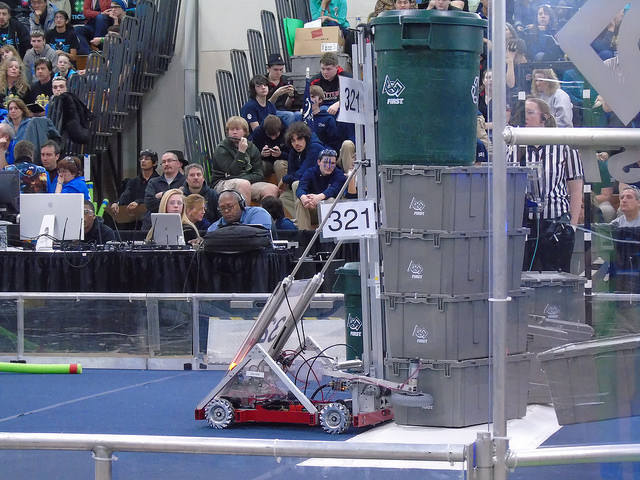

pic: 321 @Upper Darby
Specs:
Drive
  • 6 in mecanum wheels, driven by CIMs through Vex clamping gearboxes with a total reduction of 7:1 before the wheel
  • Nav X sensor to navigate mecanums
Intake
  • Inspired by Ri3D
  • Powered by an RS-775 PG71 gearbox
  • Driving 8" Pneumatic Wheel
  • Single Piston actuation
Lift
  • Powered by an RS-775 256:1 banebot gearbox, encoder for PID control
  • Two Chains circulating to pick up individual totes
  • Custom “hook” to lift totes in wide configuration
Capabilities
  • Landfill warrior
  • Can do a 5 tote stack from landfill and cap it
  •   In auto can drive forward and manipulate either tote or container
Stats
  • 78 district points (currently 23rd in MAR)
  • Rank 11, Alliance Captain 8, Semifinalist at Springside Chestnut Hill with 484 and 3637, Creativity Award
  • Rank 7 Upper Darby, Alliance Captain 5, Quarter Finalist with 484 and 1495
