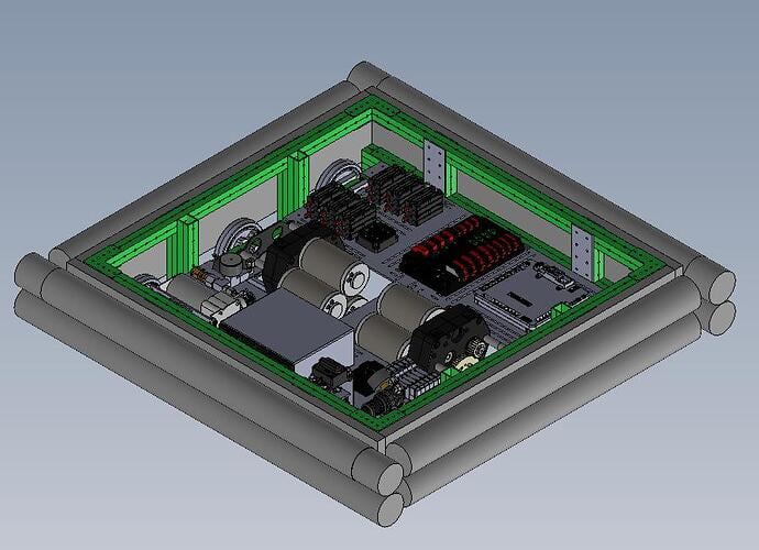

pic: 3538 6 Wheel Tank WCD Screenshot
Screenshot of off-season drivetrain with bumpers.
Improvements
-Switched from 9mm belts and 36T pulleys to 15mm belts and 24T pulleys to prevent belt breakage
-Added mezzanine for bumper mounting
-Stronger gearbox braces to reduce vibration
-Flat waterjetted belly pan for electrical mounting
If interested in the CAD file then PM me (we don’t have a website yet). We have both STEP and Solidworks files.
