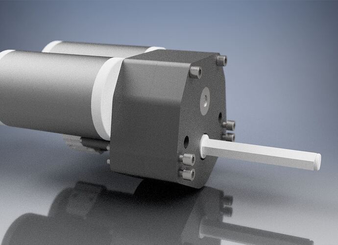

pic: 3D Printed Shifting Gearbox Housing
I decided to try to design a gearbox housing that could be 3D printed for a two speed gearbox that I designed a while ago. I did my best to design it in a way that the material properties should not have to be superb, but I’m not an expert in 3D printing, and I’m looking for feedback on the design. Do you think it could be adequately printed on a prusa i3 mk2? what material and print settings would you recommend? On a chain in tube WCD with 3.5’’ colsons, do you think it could survive a season?
Please take a look at the CAD before providing specific mechanical critiques.
Here is a link to the CAD. Native Inventor and STEP files are in the folder.
I won’t comment on your design, but I may be able to help with material selection. The Mk2 has a maximum printing temperature of 300c, so your options are pretty open. I’d recommend Nylon and Polycarbonate, but both of those can be a pain to print even after getting your settings dialed in and quality spools are still expensive. Nylon also has a nasty problem with fume emission and rapidly absorbing moisture, which can make it unprintable without the right precautions. If you want something that’s inexpensive and easy to work with, I’d go with PET or PETG. It’s the same stuff plastic bottles are made from and it’s become quite well known for fantastic layer adhesion and high strength in general. If you’re willing to spend the time to get PC to work with your machine, it might be a better option.

Thanks for the info. Team 2471 doesn’t have a Markforged or Stratasys, but I’m curious what you would recommend on those. I’m also wondering how ABS would work in this applictaion.

In my imagination (disclaimer: my imagination has no correlation to the real world), the first failure would be the weight of the CIMs bending the entire gearbox, especially as the plastic softens from the heat. I thought of several ways to help this issue:
  1. Use a material with a higher melting temperature to lessen the risk of it softening (so, not PLA).
  2. Printing extra bits that directly support the bottom of the CIM
  3. do what 5012 did earlier and print with the “grain” in a good direction (tbh I’m not really sure what that means or what that does but I remembered it was a thing).
  4. Putting more vertical distance between the mounting bolts.
  5. Lightly press metal spacers into the gearbox’s mounting holes and bolt that tightly to the drivetrain.
Btw, assuming this is for a WCD setup, where do you plan to place the chain?

All in all, this looks like a pretty great design for a 3d printed gearbox, though you might be able to make it a little bit better.
First off, what’s driving the spacing on the four main mounting bolts? There’s less than a half inch of vertical distance between those bolts, and any fraction of inch there will make the whole assembly considerably stiffer.
Secondly, is there any gap between the halves of the housing? Getting the tight fit you want can be a little tricky without a lot of familiarity with your printer or a test print or two. Orrrr, you can possibly cheat and print in a groove for an o-ring; that’d let you get away with a less exacting tolerances and still have a grease-tight gearbox.
Thirdly, I’m not a huge fan of the pneumatic mounting. I’ve used a very similar tactic with printing drop-in slots for hex nuts. It’s one of those solutions that gives you a nasty feeling in the pit of your stomach, but sometimes it’s the best solution you’ve got. But I think that you could use heat-set threaded inserts here with success. And if you’re not comfortable with that, you might be able to use hex head bolts so that you have something a little easier to assemble and keep together.
Let me know if I missed anything or if any of this advice is absolutely unfounded!
