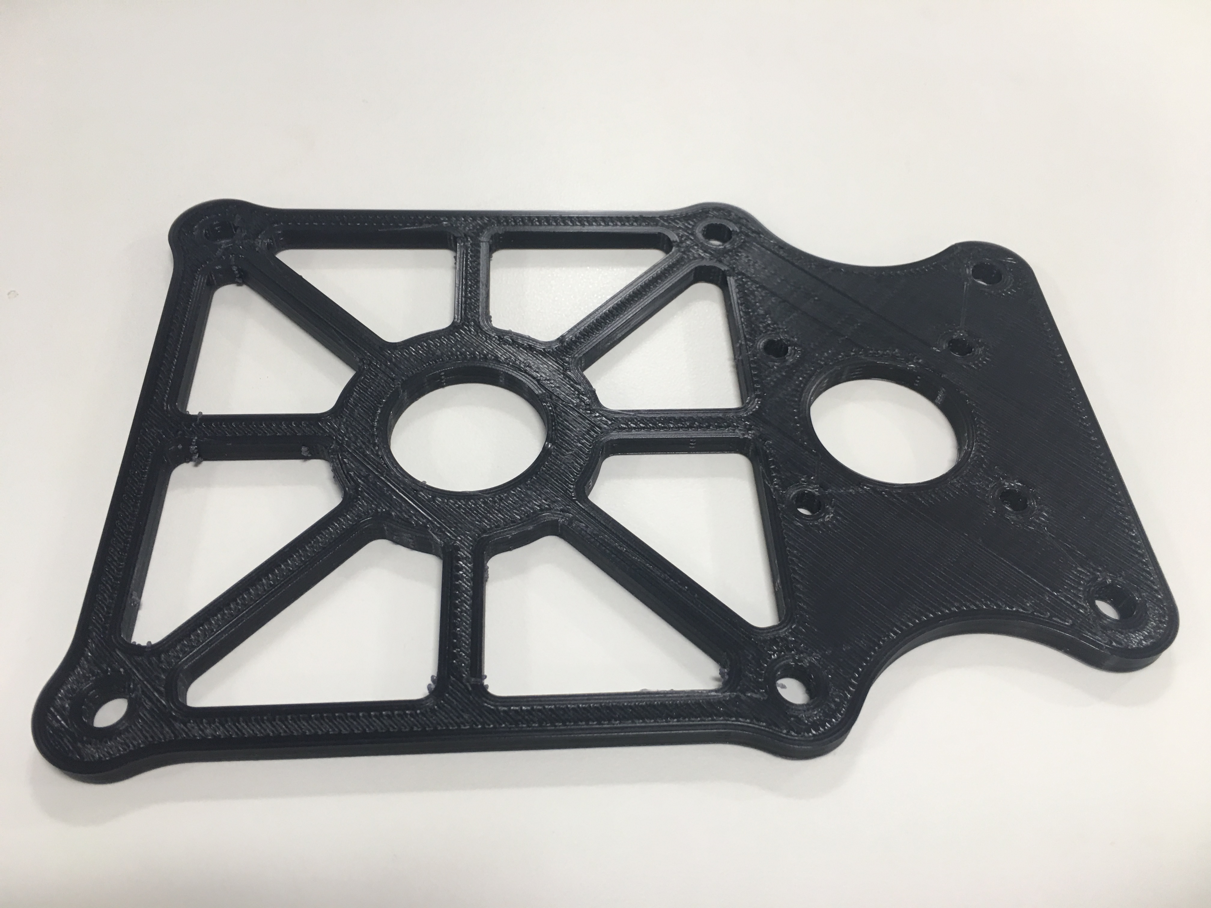

pic: 3D Printed Single Stage Side Plate (Alloy 910)
1/4" thick, Alloy 910 3D printed side plate for a single stage reduction (34:84 Vex Pro)
I’m not very familiar with Alloy 910 other than knowing it is a strong 3d printed material, but I probably would have designed this a little differently. With 3D printing, you are not limited to 2D lightening patterns in the way a waterjet piece of metal is. You could leave the top and bottom faces solid but thin, while doing your lightening within the material, to make a stronger honeycomb type structure that is more rigid than a traditional webbed lightening pattern like this.
Also I may be superstitious but I would have made the plate 3/8" thick, to be safe. Its not like weight is an issue with this kind of material + infill settings.
I’ve had the idea to try printed side plates for a while now; just now getting around to putting the plan into action. I haven’t been able to find anyone else trying this out (after a cursory search), so I wanted to facilitate some discussion here.
This print is not completely solid (~50% infill, 3 solid top/bottom layers, and 3 perimeter layers). My lightening pattern is solely to reduce print time and material consumption (Alloy 910 is about $35/lb). I chose 1/4" as a thickness to provide full bearing contact with a Vex flanged bearing. The perimeter hole pattern is to accomodate 1/4-20 bolts for some standoffs between side plates. If i run into loading issues with these, I’ll probably embed metallic bushings into the holes rather than increase print thickness.
This print is extremely stiff in-plane. I can’t break it. I’m convinced that one of these could survive a FRC application if coupled with some aluminum structure that limits out of plane shock loading to the printed parts.

You could probably get a bit more strength-to-material ratio by increasing the shell thickness and going down to 33% infill or so, depending on the pattern and how well the print seals up on top and bottom.

I use a Lulzbot Taz 5 and its heated PEI bed with some disappearing purple Elmer’s glue stick applied to the print surface beforehand.
Any printer capable of ~250C in its hot end should be OK for printing with Alloy 910. There is some discrepancy between the filament manufacturer (Taulman) and my printer manufacturer’s recommended bed temperature for this material. The Lulzbot profile for this material has a bed set point of 100C, while Taulman calls for 50C. I’ve had good and bad results with both bed temps. One day I’ll isolate that variable and run some tests. I’ve found the Taulman parameters for retraction, print speed and such to be spot on.
I keep my filament in a sealed 5 gallon bucket with a desiccant. Honestly, I’m not convinced it’s that major of a variable with the parts I’ve made. I used to be religious about keeping the nylons dry, but have had great quality prints after forgetting about a spool and leaving it out (in an air conditioned environment) for a week or so. Sometimes i notice bubbling, and sometimes I don’t. If the bubbling gets out of hand and prevents a good first layer, 12-14 hours in the desiccant bucket seems to sort it out. I’m not sure humidity has ever caused a failed print for me, but it can definitely affect print quality. I have yet to throw a spool in my oven.
