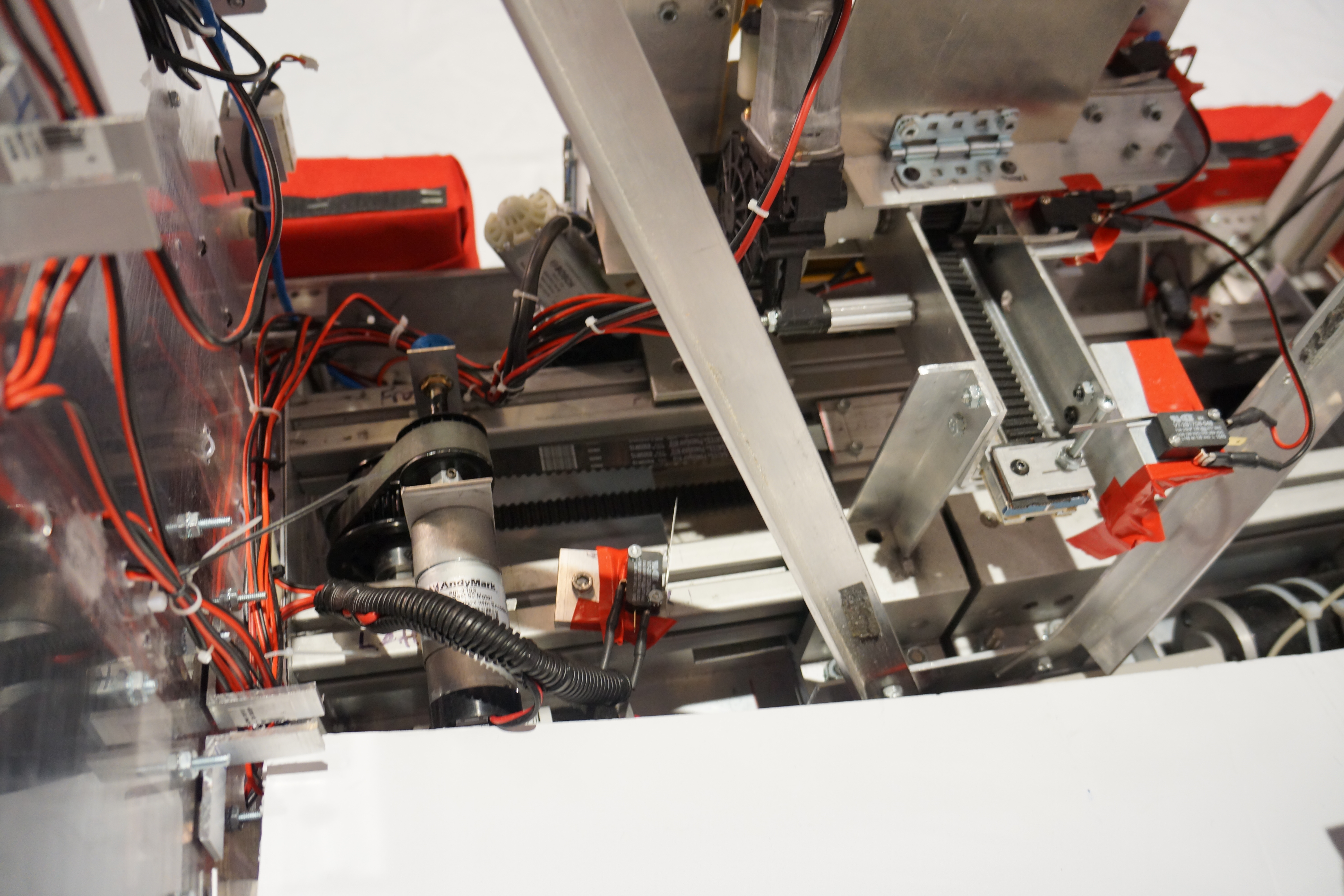

pic: 4513 Gear Mech 2

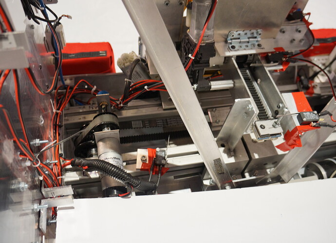

slider mechanism is shown, window motor hooked to a belt moves the mech left and right until it trips a limit switch (right side shown to the right of the window motor) which will stop the motor.
