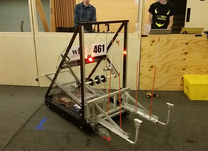

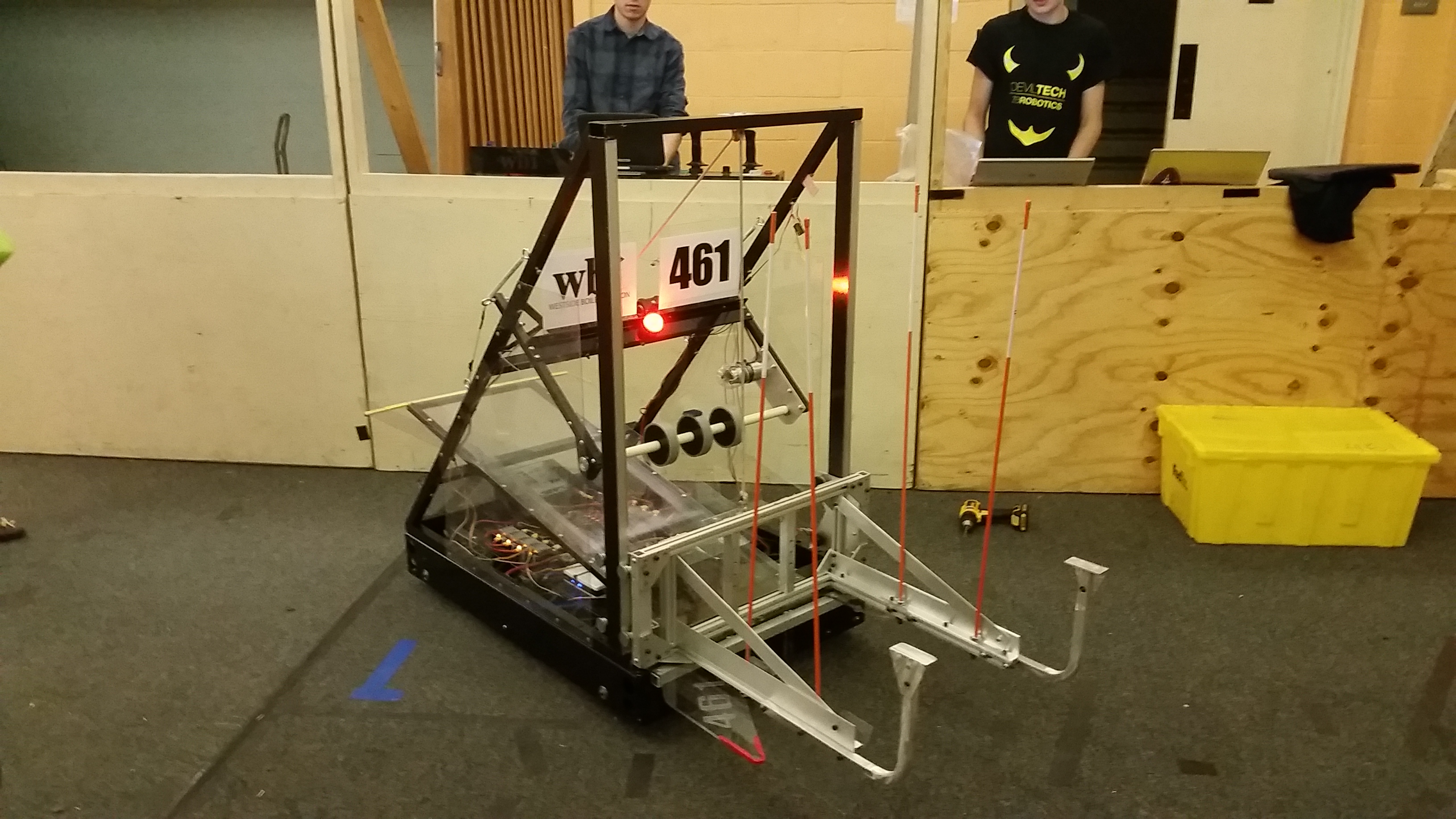

Our 2015 robot to play Recycle Rush
Drivetrain: 2 cim and 4 mini cim slide drive
Manipulator: Passive lexan teeth with tusks for recycle bin
Lift: Mini cim in a 16:1 versaplanetary cable lift
Intake: Ramp and roller system to hold 2 totes in the back
