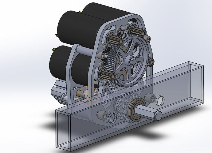

This is the first gearbox I have designed in Solidworks. I normally use Inventor, but I am required to take a Solidworks course for my engineering program, so this is my final project.
This design took some inspiration from Chak’s gearbox found here.
It is geared for 9.6fps free speed in low, and 21.4fps free speed in high, on a 3.5" wheel.
This design is entirely reversible. Meaning it can be installed facing the other way with no modifications to the parts.
Questions and comments are more than welcome!
It doesn’t look like your 775pros have flux rings( the little sheetmetal ring around it which is about 1mm thick). You might want to get a different CAD model, as 775pros with flux rings probably won’t be able to fit through the holes in the gearbox plates.
You really need flux rings on your motors.

Two reasons: (1) they contribute to the motor’s performance by getting more magnetic flux to the rotor, and (2) removing them is an illegal modification per FRC rules – or I should say it has been for as long as I have been a robot inspector. I don’t forsee that rule changing.
Back on topic: this is a really neat design. The outboard 32DP gear meshes will need shielding. What C-C distance did you use between the cluster and the output shaft? Like a ball-shifter, or a DS, or an EVO, or something custom?
Very well done, Bryce, I really like it. I’d wager it’ll be tough to get a 4 motor shifting 775pro gearbox much better than this (incoming 7 people saying that can easily make it better). I’d maybe consider adding some sort of bearing plate on the other side of the tube that connects back to the gearbox for a little more support, but either way it’s still a great design. Do you have an approximate weight on this thing? The pocketing is really solid all around and it looks comparable to most 2 CIM shifting transmissions in terms of how heavy it is.

What a clever take on a 775pro gearbox! Honestly, I can’t find much to critique except maybe the non-COTS 85t gear (unless that’s a modified AM one?) Does it use a COTS shifter shaft?

Oops. I’ll have to fix that. Hopefully it won’t affect too much else.
The final stage has a C-C distance of 1.452". I’m not sure if any of the gearboxes you listed use this or not.
Thanks! I have used something just like what you are describing on gearboxes in the past, and it worked great. However, this year the team ended up not using any exterior support on a three CIM gearbox, with no problems, so I’m no longer convinced that it’s necessary.
Solidworks says 4.97lbs. That seems a little optimistic to me, but I guess I’m not used to working with drive motors that are only 0.8lbs.
Thanks! The 85t gear is CADed as a modified AM, but it would probably remain unmodified if this was ever built in real life. The shifter shaft is a simple custom design, much like what 2471 has used in the past.

Seems like your material properties in SW is correct, we were at 5.6lbs with 4X 775Pros on each gearbox, including all fasteners and about 8" of 10ga wire and connectors on each motor.

The extra volume in my mind is non existent. If you compare this gearbox to any three CIM gearbox, the total volume taken up will be significantly lower. I think it is even a significant volume savings when compared to most two CIM shifting options. The lower durability is definitely a concern, and it is an unknown quantity to me right now. But it sounds like burning motors can be avoided with good gear ratios and software.
