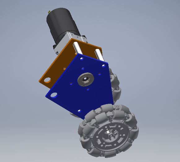

pic: 775pro perpendicular drive module
here’s a rough idea of the perpendicular drop drive I want to implement with the 775pro drivetrain I have been working on.
It would be pneumatically actuated, and rotates around the .5" hole in the bottom left corner.
weighs in at just over 3lbs with two 4"omnis and the 775+vp.
1/8th plate.
