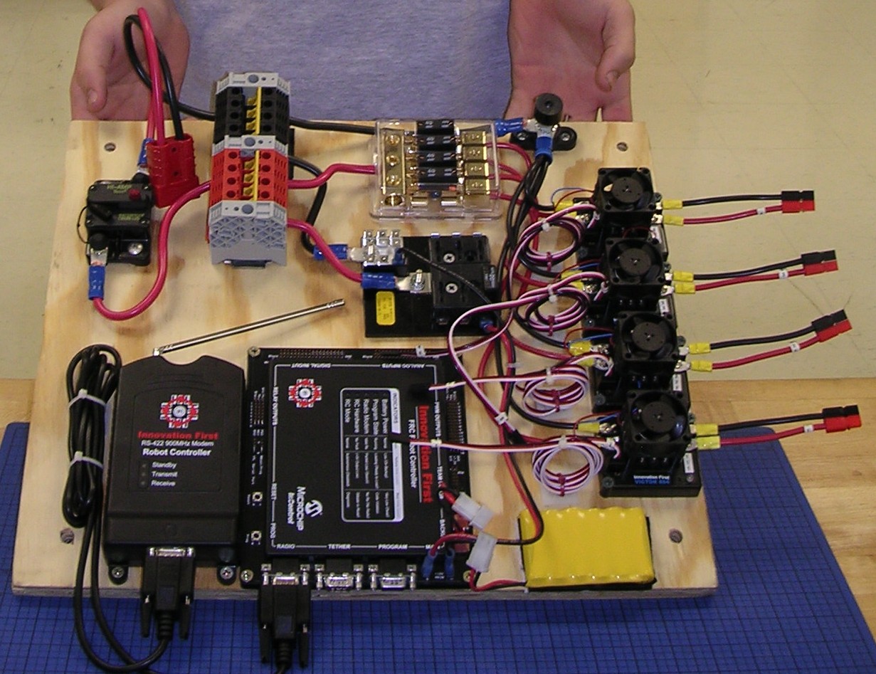

931’s preliminary electrical system layout for 2007. Mounting hole pattern is 16"W to suit a 27" wide kitbot chassis. Our initial concept is that this panel could connect to smaller remotely located panels that would serve the arm, pneumatic system, and/or other possible functions via additional 6 AWG circuits wired to the DIN Blocks.

The negative terminal post in the top right corner of the picture is not show on the 2007 Robot Power Distribution Diagram, and does not appear to be from the KOP. It also seems to defeat the purpose of the black Power Distribution Block (whatever that purpose might be). Are you sure it’s allowed by the rules?

The 3/8" stud you see was a KoP item in previous years, and would be considered a COTS COMPONENT now. As such we will need to account for its cost in our materials list, and make sure that it complies with <R63> since, as an electrical conductor, it might be considered a custom circuit.
EDIT: of course under <R47> the stud is an additional electrical component, and as such would not be allowed if it is not COTS.
EDIT: Post Count = Team Number. :cool:
<R57> does not seem to specifically address the negative power distribution, but from the specifics of the positive power distribution description, I would feel much safer about passing inspection by using only the new power distribution blocks and fuse panels for all intermediate connections.
I honestly think that you could simplify your wiring and lose some weight if you moved the din rail closer to the radio and got rid of the stud and crimps. Thus causing one less location for something to come loose. Or better yet use the Negative posts on the smaller breaker panel. Or, I’m not sure if its required to use the din rail but you could totally eliminate the din rail and run the negative to the stud and the positives through the maxi-block.
Just a thought. I dont plan to use additional items.
-Mike
Thanks for the weight saving idea. We do plan to compress the layout after some other chassis decisions are finalized, and we may lose the stud at that point.
However, I am pretty sure the DIN Block is required per <R57>.
EDIT: also I am pretty sure that wiring 40A circuit returns to the smaller breaker panel is not allowed.

The connectors on those speed controllers(red/black)…They seem very nice…look like mini battery connectors and easier than two quick disconnects terminals. Where did you get those? :slight_smile:
Those are Anderson Power Pole connectors in the 15/45 Ampere size as shown here. You can get them through several distributors. A low cost crimping tool for their terminals is available at West Mountain Radio.

Looks really cool, nice job! I would eliminate the ground stud and return the negative leads directly to the distro block. You save some weight in #6 and crimp on connectors and lower the series resistance, not to mention a single point failure if the stud hardware loosens.
How do you like the crimper and the Power Poles so far? We add a touch of solder to the connector just to be sure, before assembly. They crimp on the #12 Chalupa leads OK as well, but again a touch of solder just to be sure.
Thanks, Al.
We will probably lose the stud when we compact the layout somewhat – right now the footprint is still too large. I agree the stud takes up valuable space and is an extra failure point.
Also, I am not sure that the stud is a COTS component. It was in an old (2003? '04?) KoP but I don’t think it was custom made for FIRST. Anyway I would need to get a part number and price to show for material cost analysis if we want to use it on the robot.

It seems to me that they were available from Terminal Supply that year.
I recall the same. I did find the 2004 Power Distribution Diagram that shows the stud. Didn’t find it at www.terminalsupply.com.
But it does seem to be available at Hot Rod Wires.
