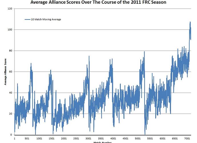

pic: Alliance Scores Over the 2011 FRC Season
This is a plot of the 10 match moving average of alliance scores in 2011. The x axis is matches in the order they were played (ie they are not sorted by event, just by timestamp). A moving average is averaging a block of matches together and basically each point you change one number in the average. In this way, you reduce the volatility of the data. The trends remain the same without the moving average, it is just much harder to look at. The data is from the @FRCFMS twitter feed, Andrew Schreiber was nice enough to mine it for me.
I think it’s neat for a couple of a reasons. There is a clear upward progression in alliance score over the course of the season. The spikes are all elimination matches, so you can see that elimination matches are clearly higher scoring. You can also see how large each week is compared to the others by the distances between the elimination peaks. Also interesting is that the Championship is clearly played on a different plain compared to other weeks, as the average match score is inline with a typical elimination round!
Worth nothing that some of the upward trend in the data between the peaks could be due to a difference in time zones as some regions may have been playing in elimination matches while other regions were still in qualifying rounds.

Observation in the first graph. from about 6400 to 6600 on the x axis looks like MSC.
The peaks from the 6 competition weeks, then MSC at a much higher caliber (quals nearly as good as week 6 elims), followed by CMP with CMP quals at MSC elims level.
