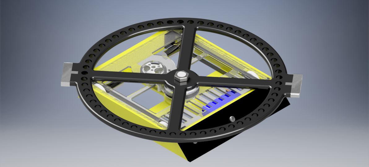

pic: Another Beetleweight (Wasp)
Flash drive containing the files for Team USA was destroyed by ignorant classmate, so I decided to design a proper beetleweight this time. Wasp weighs in at 2.85lbs with battery and features a nasty 14" diameter overhead disk riding 1.0625" above the ground. Any questions/comments/concerns are much appreciated!
David,
It’s super cool to see your designs progress. On this particular design, I’d be concerned about how you’re supporting your weapon shaft. It looks to be cantilevered off of the baseplate of your main frame? I’m concerned that it will flex just enough to drive your weapon disk into your frame, causing lots of explody fun.

If it helps the bottom plate and the chassis are all one part (it’s abput 3/8" thick where the weapon shaft goes through). Any ideas for removing the explody-fun-time issue?
I can’t find any good pictures at the moment, but look around to see how other full body spinners do their bearing setup. You’re specifically looking for ones like Megabyte or Capt Shrederator whose disks pivot from the top of the frame as you’re trying to do.
You probably want to support that shaft with a frame attachment somewhere as close as possible to your weapon disk.
It’s hard to tell just by looking at it, but it looks like the weapon is heavier than the drive? Whichever component requires less torque to spin up(generally whichever is lighter) will spin up first. If your drive requires less torque to spin relative to your weapon, your drive is just going to spin out. And that’s all before your drivetrain loses traction - the only force preventing it from spinning relative to your weapon. I know the driver for Megabyte lurks around these parts. He could probably explain more than I ever could.

Well thank you! I checked and the weapon assembly is almost exactly 1.5lbs (its like 1.4875ish))
