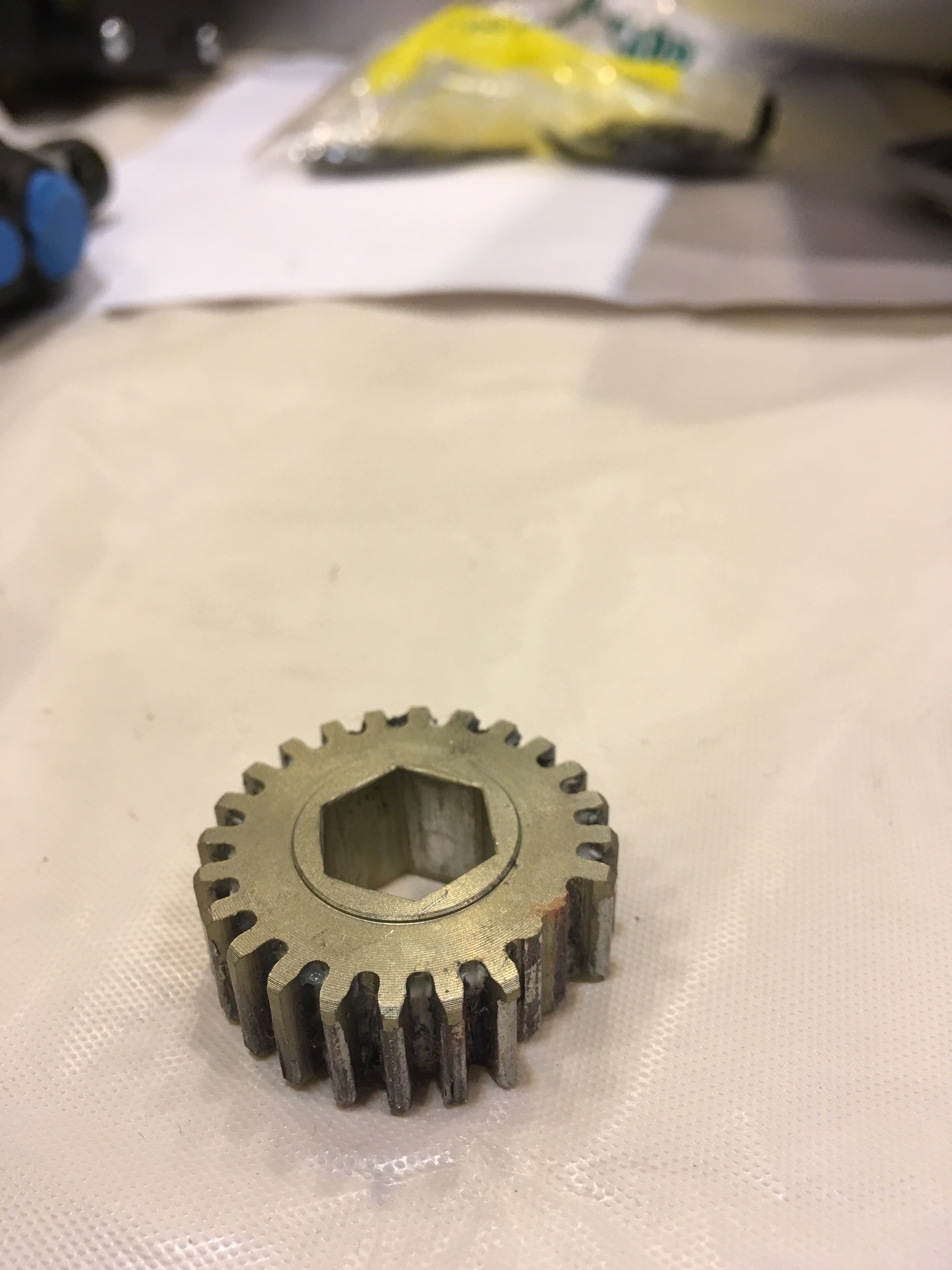

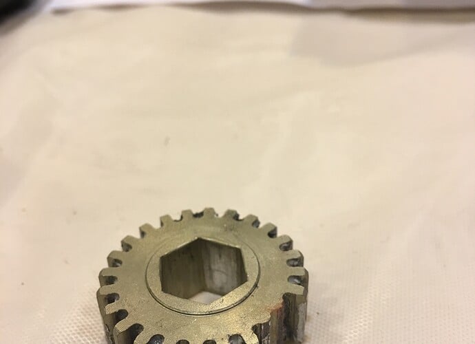

pic: Another stripped VexPro gear
We did it again! This time not as bad. As it happened on the same gearbox, we’re concerned something might be wrong with it. We will tear down the old gearbox tomorrow, but for the meantime we swapped one in. Hoping to scrounge up from some steel gears to replace them when/if this one fails.
For other teams to identify potential failures before they happen, would you mind expanding on the circumstances that led to the failure?
Specifically:
  • Wheel Size?
  • Overall reduction in gearbox?
  • Any additional reduction after the gearbox?
  • Did the failure happen while driving on flat ground, or as a result of an impact?
We noticed a similar failure (but in a 14 tooth), that can probably be attributed to sudden impact combined with materials that don’t have impact resistance as a strong point.
There’s quite a lot of good learning (and fun!) to be had going down the failure root cause analysis road.

Ok, I’ll provide the details in order. Wheels are 8" AndyMark pneumatics. Overall reduction is the standard 2-CIM ball shifter from Vexpro with the 60:24 3rd stage. We’re pretty sure it happened while being pushed by other robots and hitting defenses. Thankfully, the guys from 254 came through with some extra gears for this. I’ll try to find Vexpro tomorrow to talk to them about it. Also, if you think that’s crazy, I’ll post a picture of one of that we stripped today that only has three teeth left :).

With 8" wheels, people aren’t quite taking into account sudden shocks that can be imposed on gears with the torque of 2-3 CIMs in a gearbox. Start doing some Lewis Gear equations and use a decent factor of safety. Vex gearboxes weren’t meant to do certain things, and as a designer, you need to determine whether the gearboxes can handle the loads you’re putting them through. If they can’t, you have two choices: find another gearbox or modify the COTS gearbox to make it work.

Or … It might be the way that you are using the gears (or it might not).
More stress than the part was designed to withstand = It breaks.
How do you know that you aren’t exceeding their advertised ability to withstand static or dynamic loads?
Instead of writing “it’s the gears”, you might need to write “it’s our robot”?
Blake
How would you test that without ruining gears?
I mean you’d have to test it to Vex’s specification and then risk testing it in a drivetrain.
Testing to Vex’s specification would rule out defective gears…testing your drive train would demonstrate a design issue.
You just have to calculate the theoretical max torque based on the Lewis gear equation, then include a factor of safety.
All I’m saying is, even the strongest gear teeth will break off when subjected to too much stress.
If that happens, you don’t write, “it’s the gears.” Instead you you would write, “it’s our robot.”, or “it’s our driver.”, or …
