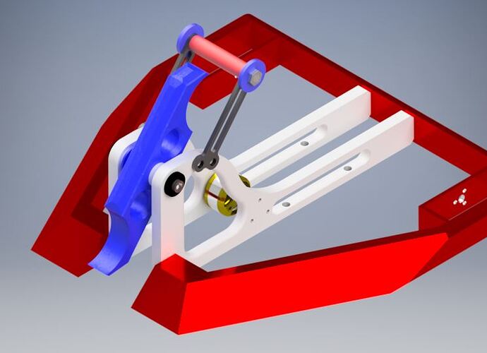

pic: Another USA Update
carpedav000
It’s been a while and the design has changed a lot since the last update. Added a much meaner weapon bar, rollers for driving upside down, and (most noticably) a whole new frame! As always I live for the questions/cooments/concerns. Thats how these projects evolve
shuki
Like the new aggressive angles on the frame, although you might wont to consider putting a little more material behind the tip of your weapon, it seems a little thin. overall it’s looking really good.
carpedav000
#3
Why thank you! It looks thin because of the chamfer, but it’s still over 0.5" thick at it’s thinnest point. However; if it becomes a problem I’m sure I can play around with the geometry a bit.
