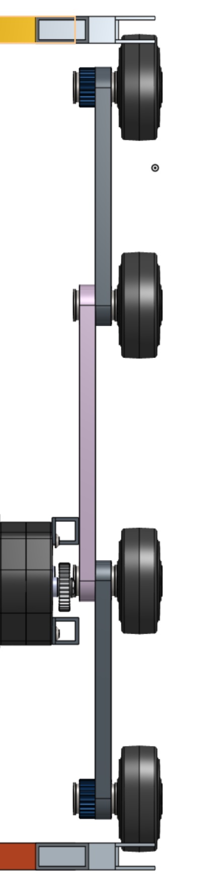

pic: Belt Layout
drivetrain
frc319
timingbelt
Ty_Tremblay
June 22, 2016, 10:03am
405×1746 46.2 KB
30mm is a little wider than the 1" gap between the bearings in the tube walls. To compensate, the custom pulleys are pocketed on the ends.
