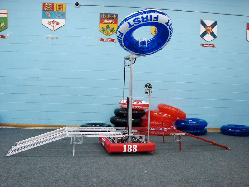

pic: Blizzard VIII
We are very happy with the outcome of this years robot. Our first regional will tell. SoCal be ready for the Force From The North. The Blizzard is on it’s way. Better get out your warm woolies.
The design is excellent … something I have grown to expect from your robots year to year. just excellent. two questions, first is how wide the ramp parts that the team’s wheels will ride on… can’t quite make out how big of a gap that is in the middle. second question, how do you pick off the ground I am not quite seeing it, and am quite interested (or do you plan to only pick from the human loader).

Taking bets on how long it takes for that camera to get killed? :yikes:
The ramps have 2 different widths. We believe that we can can 2 robots with 28" width or one 28" and one 38". Yes we can pick off of the ground.

anyway, that’s what i was thinking the first time i saw it, hopefully when the ramps are up it protects it also. Looks good steve, are we goign to see it in Rochester sometime? either FLR or offseason?
I think that arm has a one stage lift and a rotating arm. Hence when the lift is collapsed the arm reaches the floor.
Camera is only needed for 15 seconds. If it breaks, so be it. As for Rochester, neither I or the team will make it this year. I am planning on attending the one and only Rah Cha Cha Rukus. Not sure if the team will be able to make it though. Ramps, what ramps? :rolleyes:

so, what’s the protection of the camera anyway?

The post is inside of our bumpers and very close to the ramps. If we are contact there we are being hit outside of our bumper zone. That is a chance that we are taking.

Couple of questions:
Does the camera track while you’re moving? I’d worry that it would wiggle too much on the end of the support to maintain lock on the light.
Is there a stop for robots once they get onto the horizontal platform? (I can’t see one in the picture). If not, are you concerned about the robots driving over the edge?

How do you deploy your ramps?

Airline cable connected to two pins which hold the ramps upright. The cable is linked to a window motor in the centre of the robot. Soon as we need to deploy the ramps, we just run the motor. Originally we tried with a servo but it ended up not being entirely reliable. I’m sure someone else can provide more detail! There are also turnbuckles to adjust tension.
