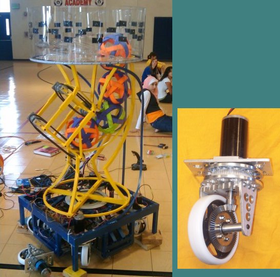

pic: CRUSH 1011 Lunacy machine "Zeek" (with swerve module detail)
CRUSH1011 robot for Lunacy has a swerve drive, gravity fed belt driven ball shooter with camera control, and hopper for loading by human players.

entire lower half of the robot was made in cad(with the exception of the steering motors being off an inch or 2 due to belt issues)
this is about the 4.5 week progress picture. i have the cad files on me now, but 09 inventor is still downloading.
http://static1.filefront.com/images/personal/m/maxoc/117211/zbgpszsmah.thumb500.jpg
ill have to go back and recolor everything correctly and redo a better render.
maybe get the upper half of the robot modeled as well, just for shiggles.
thats wheel design v.14 a lot of thought went into this new swerve drive. cut the weight of the wheels by a significant amount, made them skinnier, shorter, include the motor in the assembly, and prettier than our original swerve drive.
