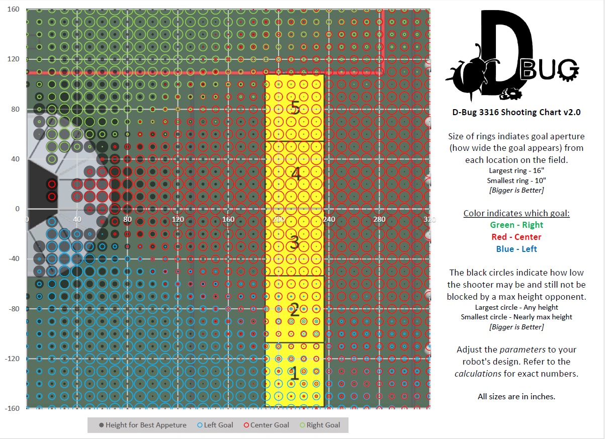

pic: D-Bug 3316 Stronghold Shooting Chart v2.0
D-Bug 3316’s new and improved shooting chart for the Stronghold challenge. A useful utility to decide which shot is best from each location on the field.
Additional charts and excel sheet here: paper: D-Bug 3316 Stronghold Shooting Chart - CD-Media: Papers - Chief Delphi
This really impressive, I’m assuming it was made in Tableau? I think this really supports that “pin the tower” concept.
All in Excel. You can find the spreadsheet here: http://www.chiefdelphi.com/media/papers/3218
Not sure about Tableau, but I would have used matlab if my matlab skills were better. It can basically visualize any piece of data you want, though it may take some effort and significant skill.
