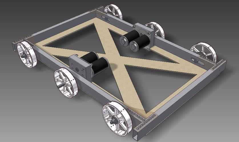

pic: Dead Axel WCD
drivetrain
wcd
nnfuller
December 21, 2011, 8:13pm
837×498 50.1 KB
Pretty simple:
Sliding Nylon Bearing Blocks.
Toughboxes direct drive 6inch performance wheels.
25 Chain drives outside wheels on 1/2" bolt axles.
Belly pan 1/4" Plywood
Gussets 1/8" Lexan, Riveted with 3/16 rivets
