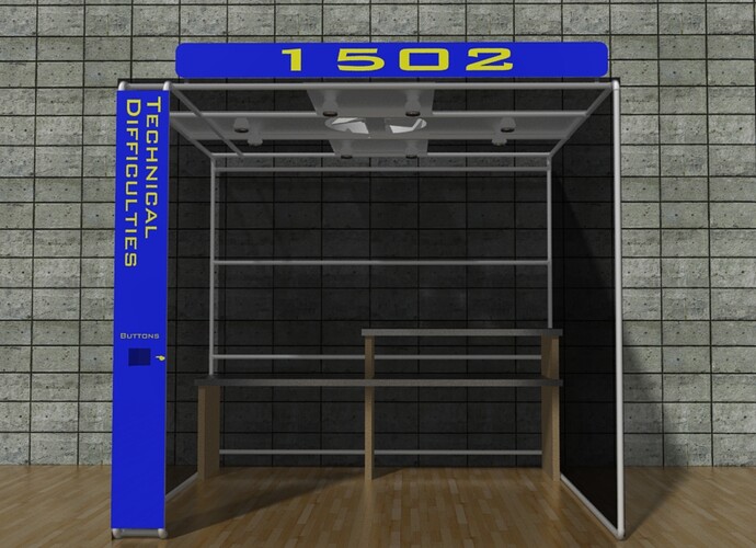

pic: Design Challenge: Pits
I’d like to challenge anyone to design what you think is your dream pit. Mine isn’t shown as completed to not spoil what may come, but to get the ball rolling. However, I’ll post mine completed sometime soon :slight_smile:
*Must meet all pit requirements and must be feasible
Keep in mind that rookie teams may use these to help them design their pits.

I’ll grab some pictures when I get the chance of our pits. As far as it goes, we’ve just got two student built diamond plate drawer things. We added a tent like structure of advertisements. I must say though, we tried adding “walls” at GKC, and I absolutely hated it. It makes the 10x10x10 just so much darker and much smaller than it really is.
The reason mine has walls is for the fan on the top; we stay cooler. To solve the “wall” issue, we shall use essentially shower curtain material as it can be easily folded up and will still let light through. However, we won’t have an issue with light; The model I made has 8 light sockets (for FIRST Bulbs :yikes: )
One thing to remember when designing your pit is that some venues may not be able to provide a 10’ x 10’ pit space. I believe that teams going to the Championship this year were warned in Bill’s Blog that this may have occurred in St. Louis. (I’m pretty sure that all of them ended up being 10’ square.)
Michigan’s events are usually 8x8. :frowning:
A roof is pointless. It’s unlikely to rain indoors, and it’s one more thing to break and fall on your heads. Besides, it’s likely going to result in insufficient lighting, and when the roof falls on your heads, the lights you install will fall too, catch fire and burn the pits down. The venue’s lights are free; use them instead.

Building on Tristan’s post, the single greatest improvement, from a safety standpoint, is having sufficient lighting to work with tools in your pit. When you cover the pit, it makes it difficult for your team to work. While I have seen teams mount lighting on the structure, I must remind everyone, that there is ultimately the chance for a shock hazard. I have seen some teams that were asked to remove lighting by UL Safety people as being unsafe. While on the subject, many of these coverings do not provide sufficient headroom. Teams that have used fold-up tents have used everything from soup cans to custom built extensions to get them high enough to clear inspector’s heads and the robot on a work surface.

Keep in mind that there is a 10 foot ceiling :rolleyes: If you don’t make use of it then it’s your own fault. Besides, referring to earlier, I said our roof and walls are light plastic fabric and easy to remove. The lights are a nice option if we do choose to use them.
What else is going to break and fall on your head?
Max, what is the wall made of? At first I thought it was netting but it almost looks like plastic.
Just a question, but what makes the chance of shock from lights so possible and different from the tools and batteries?
