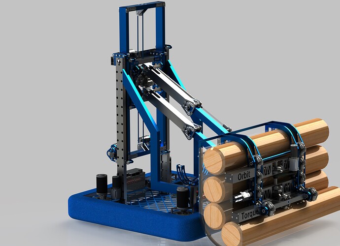

Quick render of our teams robot for the F4 CADathon, tune into the live show Augest 7th (Today) at 8PM EST to see more details on this, and many other robots! https://www.twitch.tv/firstupdatesnow

Could we get a shot of the backside to see how it rotates as it raises up?
Render of turny mechy thingy plz. :slight_smile:

This is an amazing design for a 6 week time frame absolutely insane for 72 hours. Well done!
How many people were on your team?
We had 3 people. The other two members were pretty new to CAD, with one only having it for about 2 weeks. Brant from 1477 worked on the drivetrain and added the colors, and a user here on named Nessie from 2702 worked on intake ideas and designed the bumpers.

CAD looks really good. My only real hesitance is your entire game piece manipulator is cantilevered on a single 1/2 hex shaft and the teeth of the bevel gears.
