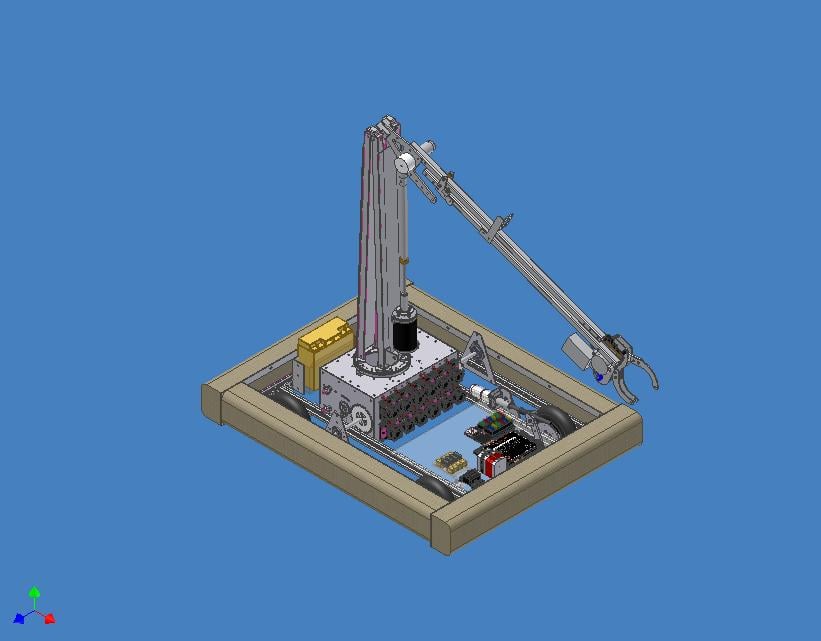

There everyone we gave into peer presure and put it up. This is the Martian robot for this year.

What are all the Victors for? Other than that, nice and simple- looks good!
render it!
Looks like the arm rotates at the base, am I correct? Which answers my next question of why you don’t have any ramps. They would probably get in the way of it rotating. Looks nice, can’t wait to see you at GLR.

thats 8… 4 for ramps???
okay looking closer it looks like 1 window may be used for a Parking brake.
Also a possibility of 2 not 1 window for control over both parts of the claw

Doesn’t everyone know how the Martian Drive works. You are missing part of our World Famous drive train, everything else you hit dead on. But, that isn’t only a parking brake.(What does he mean)

This creation looks somewhat light at the moment… are there some ramps missing perhaps? I would guess that the ramps, (if any), would be side-folded platforms with individual ramps, a la 33 & 47.

Are those bumpers legal? I thought that you could not extend into the corners.
Hopefully that is just a stylized drawing. Only soft bumper parts can extend into the corners, not hard backing. You could have longer bits of noodles and cloth.

They have a 6 motor drive. 4 cims and 2 fp motors. So thats half the victors.
I wouldn’t be surprised if the martian drive hasn’t been upgraded. The “box” around it is sooooo enormous. Maybe even 8 on the drive. either way, it appears that 3 victors at least are for the arm, and 2 for brakes.

Here’s the totals:
4 small CIM drive motors
2 FP drive motors
1 Globe motor brake/ball caster actuator
1 Keyang for azimuth drive (turret)
1 large CIM for elevator (arm lift)
1 Globe for telescoping arm
1 Keyang for end effector wrist
1 Denso for end effector claw
total 12 Victors
possible late addition - Banebot motor with spike for ramp deployment

That’s a lot of degrees of freedom on that arm. I certainly hope you guys have a good program and OI.
Ours is roughly equivalent (turret, extension, arm, wrist) and its actually not that bad even when completely under human control. (Mind you, ours is running at half speed) The key appears to all in how you think about it. If you think about it as a turreted, double jointed, telescoping arm, then its rather tough to control, but if you think of it as a single jointed arm which can be repositioned relative to the robot vertically and horizontally, and use the wrist for final scoring, it appears to help.
