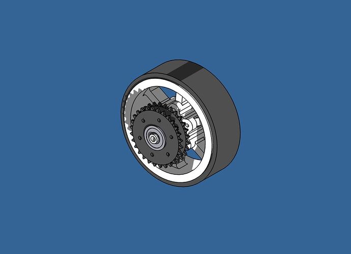

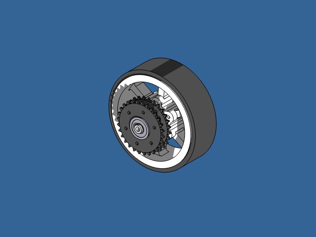

pic: FRC 1771 Wheel
This is the wheel that goes with the wooden drivetrain I designed. It is 4.5" diameter with the tread and 1.5" width. The tread is going to be roughtop. It is machined from UHMW. The entire assembly with 2 sprockets, 3 bearings, and axle weighs .6lbs.
