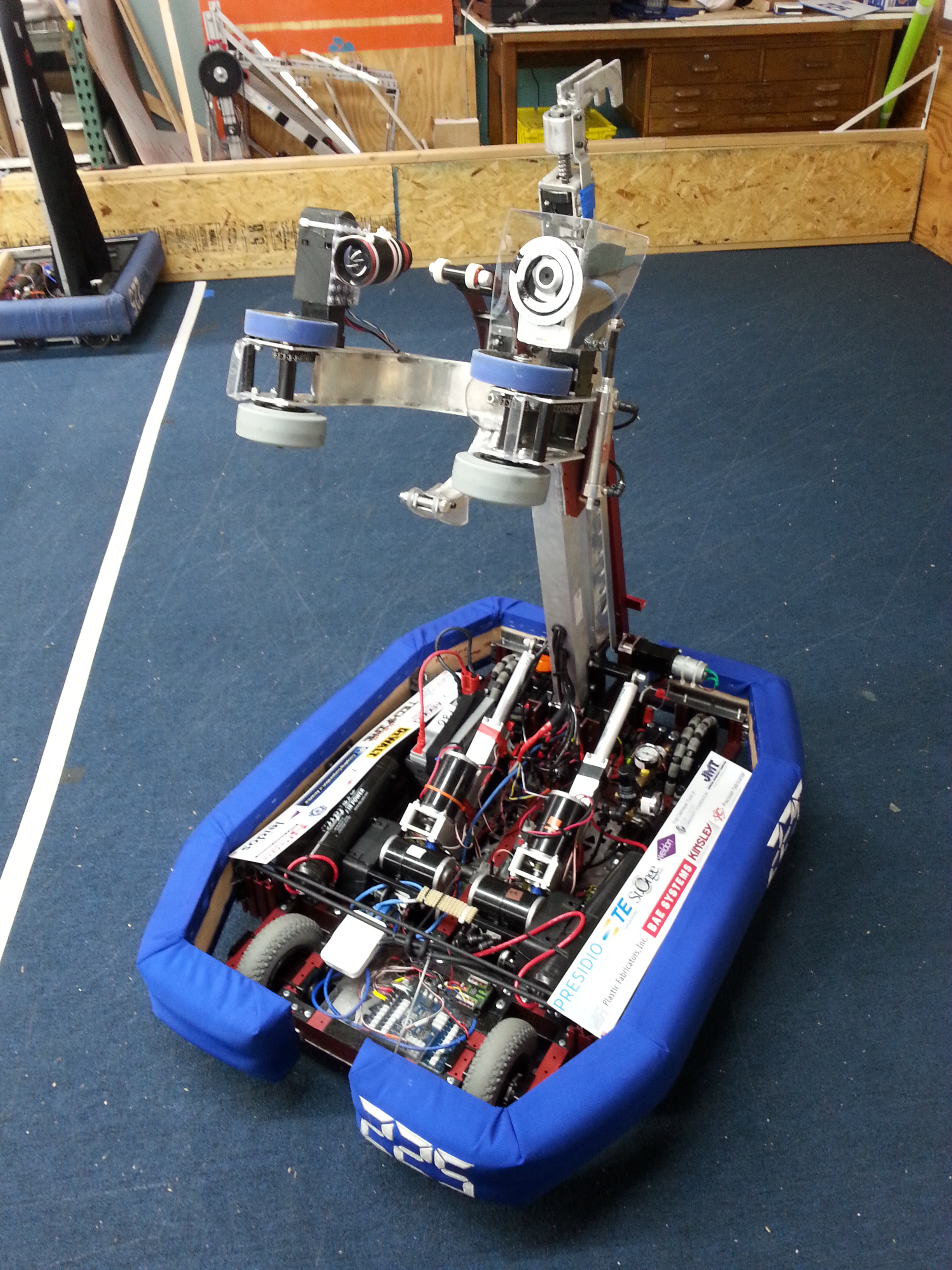

FRC 225 TechFire proudly presents our 2016 robot, “CrossFire”
Specs:
• 8 wheel drive with shifters and cut corners
• Arm powered by linear actuators
• “Tail” for wedging up the portcullis
• Intake also serves as shooter, pulling ball into a cradle and actuating a pneumatic cylinder to release
• Pneumatic ‘wrist’ for shooting over 54” walls
• Ball screw scaling mechanism
